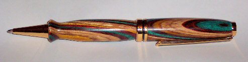

Gary ,
This is what Fred was talking about , slimline pen kit with a Mont Blanc center band .
<br />
Doug, and a very nice pen too!
Sometimes I have to bend the clip a bit at the top to make it work with thicker pens. I have a set of rubber jaws for my vise. I wrap the long part of the clip in kleenex, and clap it with about 1/4" protuding. Then I use a pair of long nose pliers with masking tape around the tips to form the clip to the proper shape.
