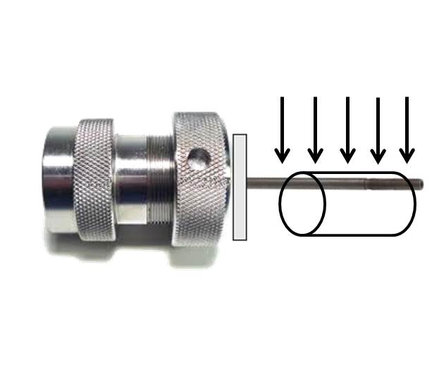

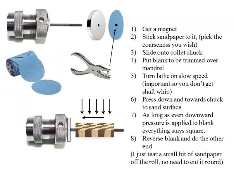

This is what I've been doing...
Questions, comments, verbal abuse all are welcome......

I wish someone made a jig that could go into my chuck that could hold my HF punches off center of my drill chuck so I could hit the sandpaper off the center of my sanding disk.
Mike, a Boring Head is ideal for off setting:wink:
Ed, theoretically I like the idea but for me any sandpaper that is suitable for effective barrel trimming just isn't magnetic. :wink:
I'm not sure that fixing a magnet ( or any other item ) in the tips of a collet is a good idea either. :wink:
Skippy; I had thought about the boring head, but it is just too 'twitchy" and not likely to be very robust.
You can get wad punches in several sizes / gauges. Black powder shooters shoot paper or card stock wads and punch them out. I use a .030 and .040 punch to make holes in sand paper. Then slide it onto a custom mandrel I turned on my metal lathe. I have about six of the punches and can find one of them that suits my hole size needs. You can buy them for a few bucks on EBay.
