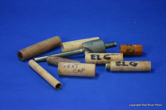

They are sleeves, spacers, or shims that fit the pilot shaft of (usually) a 7mm barrel trimmer with an outside diameter large enough to just slide inside larger tubes. Some purchase them and the rest of us make them. They can be made with most any material: wood, acrylics, delrin, corian, etx=c. Take a piece of material, drill and glue in a 7mm tube and turn the "blank" to fit inside a larger tube. The 7mm tube is not necessary but my experience is they not as fragile with the tube. See the picture.

OK, I feel dumb for asking this but, what is a trimming sleeve and how is it used?:confused:
