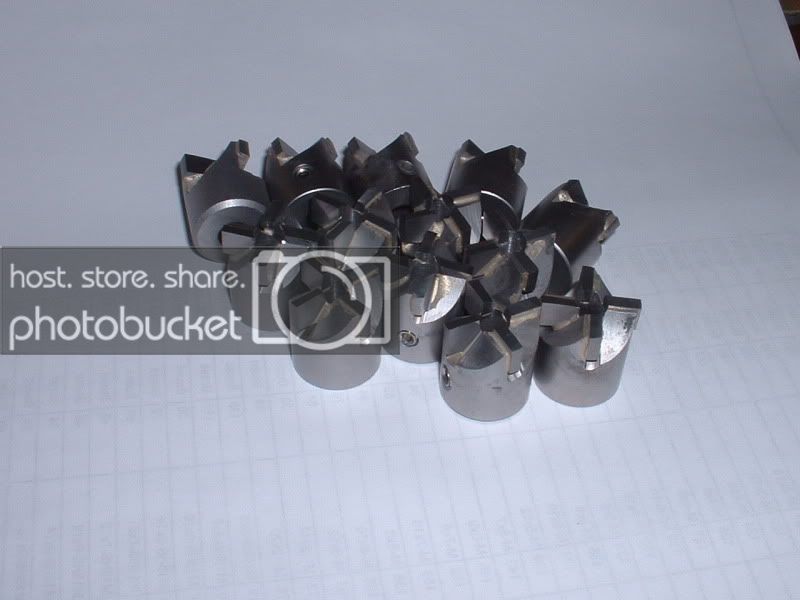

Here is a commercial source for the piloted end mill. Not cheap, $55.50.
http://www.fastenal.com/web/products/detail.ex?sku=7013376
That end mill has a shank dia. of 1/2", ok for the typical drill press. And the pilot hole is 1/4" which is important. What I do is use the various shafts that come with the pen blank trimmers we all have, insert the 1/4 shank in the piloted end mill, tighten a set screw, and you have exactly the same operational trimming capability as with a woodturning pen blank trimmer. A big plus is that the commercial end mills (counterbores) are made with quality high speed steel for use in metal working.
I use my drill press for trimming blanks, especially antler. After gluing in the brass tube I use a belt sander to get the ends more or less perpendicular to the tube. I hold the irregular shaped blank with vice-grips, and place the blank up on the pilot shaft before turning on the drill press. I have experienced no tendency for the end mill to grab the blank and twist it, but I do wear a glove. Of course the cutting edge of the counterbore is not touching the blank when the drill press is first turned on. It is so easy to trim a little, lift the drill press arm slightly to inspect for appearance of the brass tubing, and trim a bit more as needed.
I got my counterbore on eBay as a estate sale item. I'm sure the person does not have them in quantity. Here is a counterbore I found on eBay just now. (2 Dec 09) http://236n.sl.pt
Unfortunately the shank of the pilot is 3/8" - unsuitable for use with our pen trimming shafts - but this gives you an idea of what you can find on that site.

Search on eBay for counterbores. One guy sells them in lots of 10 for $150 without the pilots.
Although the link dow posted looks promising I am a bit shy on these. I have an entire selection of pilots that I have made over the years but would like to find a cutter head that is more durable than the ones that come with the kits. I don't want to buy a $35.00 cutter that does not work on the 20 plus pilots I have.
One option is to have a customized cutter head built - I think Paul H did my cutter head a year or so ago. I was doing something that needed a larger than normal pen size and he was happy to help me out.
