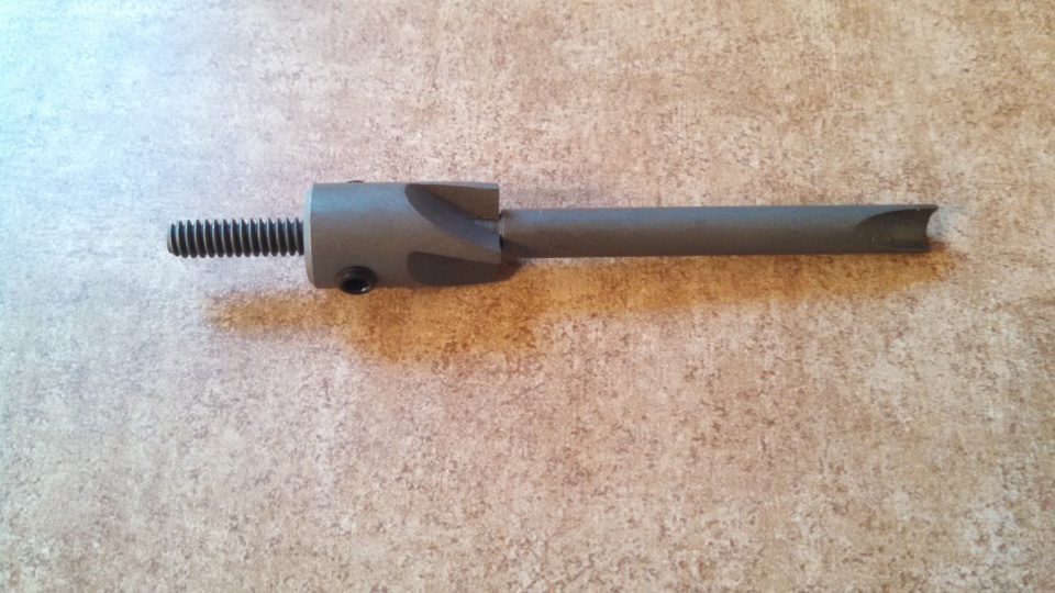

I have an extra 7mm trimmer that came with a tool lot I bought a while back. I think the guy used a lot of rockler stuff so I don't know who made this one. Its threaded but may work for you.
If interested, drop me a pm and I'll send it to you.
