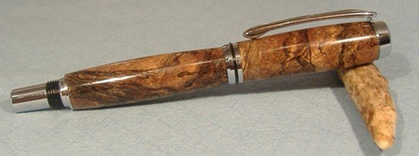

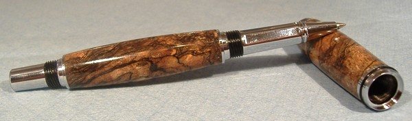

It look like you did a fine job. My only suggestion is one of personal taste, I personally don't care for that much swell, in my opinion these and the Jr. Gent/Statesman should only have a gentle curve. You are pretty close but just a touch to much. Fit and finish look very nice though. The more that you do these pens and look in other people albums you will see that some kits even look better with no curve at all, just a plain bushing to bushing cut. A perfect example is the Emperor and the Statesman, these in my opinion look much better bushing to bushing. Have fun making daw dust.
Wayne
