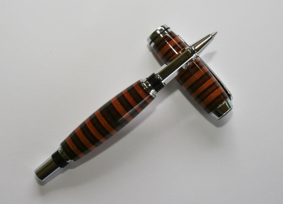

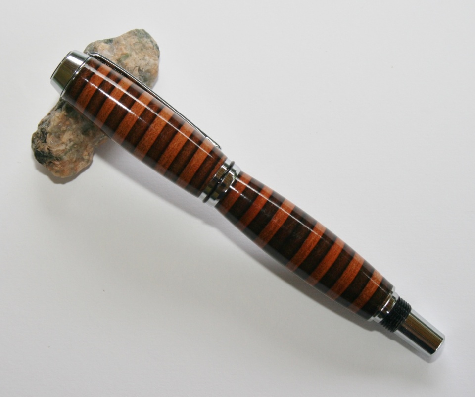

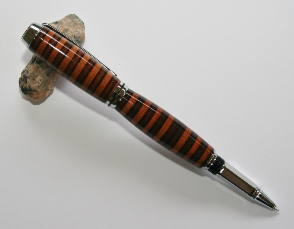

As part of my demo I did this part Saturday at the Hampton Roads Penturners Meeting I did a leather blank to show one of the many ways a segment may be done. Here is the finished pen. A chrome Baron Rollerball. I used my carbide insert chisel for all the turning, sanded to 12000 mm and finish with 20 coats of WTF over the last two days. I'm very happy with the way it came out even with I minor flaw. As always all C&C are welcome

..nice job Dan! The onliest thing I see somewhat odd is the larger center section in the middle of the lower barrel. If that is your "minor" flaw, I would not even consider it as such! It looks GREAT! ....Jan
Sure Phil I tell you then everyone will know, the next thing there will be copy's all over IAP.....wait that's not a bad idea so here we go.
1st) I cut the leather into 3/4" x 3/4" and punch a hole the size or approx. size of the brass tube I cut and punch enough for the length of the tube plus a few extra to make sure there will be some on the ends to trim.
2nd) I mix up a solution of about 50/50 Elmer's glue and water and soak the leather pieces in this solution for 24 hours I turn the blanks after about 12 hours. I remove the leather from the solution and let them dry for at least 24 hours.
3rd) I start stacking the leather on the tube spreading Elmer's glue on each piece until the tube is covered then I clamp the now blank
to compress the leather then unclamp and add a piece to two to the ends so there will be some leather to trim as you would any other type of blank then re clamp for at least 24 hours. I unclamp and let the blank dry for a few days in the case of the blank for this pen it was 3 days.
I know turn the blank as I would any other blank except the I watch the heat build as this could soften the glue this could cause some problems with the leather shifting. I same and finish as I would any wood blank.
