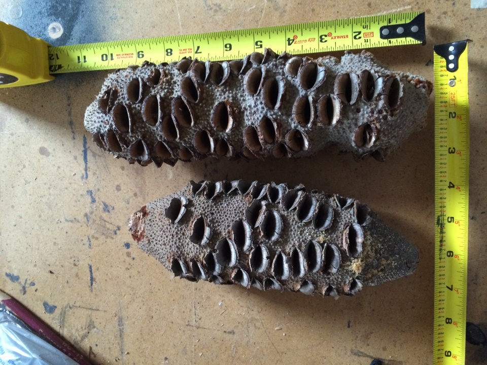

I have had a bunch of banksia pods just sitting in my shop for years. I admit, they intimidate me. :redface: Can anyone offer suggestions on what to do with them I order to turn a pen? Any turning guidance would be appreciated.

I've never made a pen from one, but make Christmas ornaments and lately a couple of novelty items. Without stabilizing, the outside 3/8" is just velvety fluff. I crosscut the length I need, then cut off the velvet on the bandsaw. The holes can be filled with seeds or parts of seeds, so I use a dental pic to clean them out. There can be some radial cracking inside them as well. The velvet will drive you crazy if you try to turn it without dust collection!
Slice them, put them in a mold and pour a casting resin (like Alumilite) over them, put into a pressure pot and you'll have some amazing results.

G'day Jim,
What sort and size pods are they...!
Show as a couple of pics so that we can see what you've got...!
I have no problems in making a few suggestion for their use, it all depends of what they are...!

I don't have a pressure pot. Any other options regarding casting?
They are hard as a rock. Here is a pix.
Yeah, those are the "giant" Banksia species, we have them growing in some areas of Australia (WA) not here unfortunately, some reaching well over 1' 1/2 in length and 6" in diameter, those are great to turn into all sorts of things.
If you were closer, I would be saying, send them to me and I will replace them with some already cast but, with the shipping cost as they are, that's out of question.
You could try to get someone closer to you to cast them for you, in whatever you would like or, you just turn them into something like these...!
