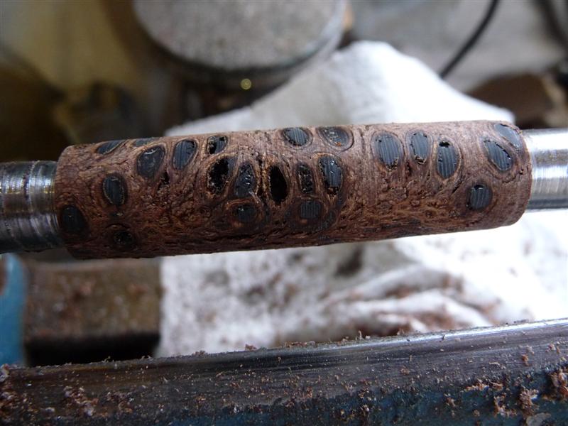

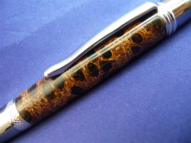

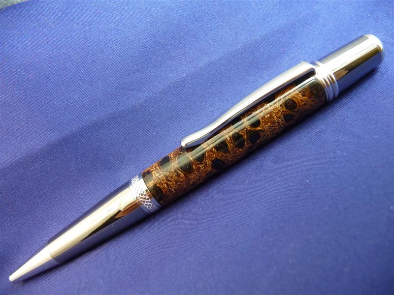

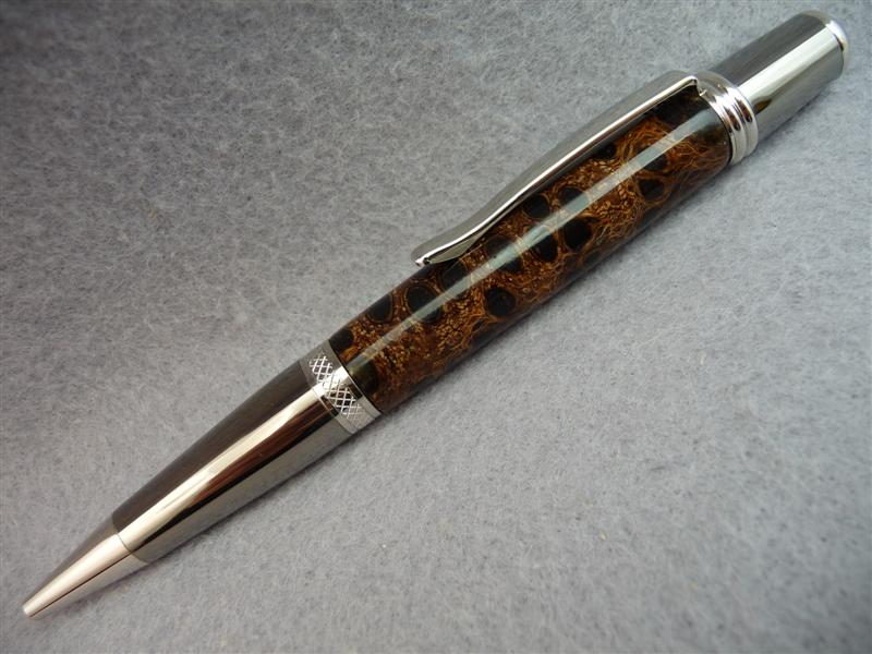

Starting to get back into it after illness, this Sierra Platium/Titanium kit in Banksia Nut, the nut was cast by a couple of Aussies as a trial, and I was blessed by a gift of a blank. The finish is CA, it was quite tricky to turn as the photos show, as holes appeared I filled with Ebony sawdust I had saved. Hope you like it. Amos

Glad you showed this pen here as well. As I mentioned on the other site that grey photo really shows that pen and kit off. Excellent photograghy on that. It is funny you showed this pen because I asked a question in another forum about how you would cast a material like that. Would you have any input on that??? Thanks for showing.
The reply on the UbeautWoodwork Forum, is that these were pressure cast, as for turning, I found it hard in some places, but after sharpening aok, the main thing to watch for is the bits that don't get stabilized can easily fall out and cause little voids, which I filled in with Ebony, some have used coffee in a slurry. Amos
