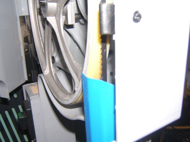

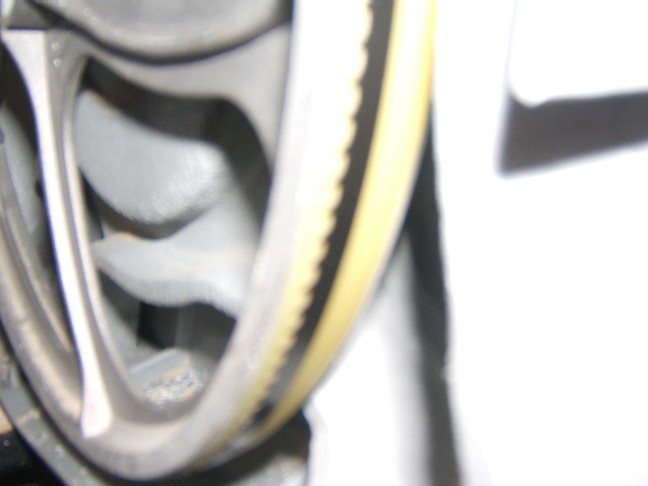

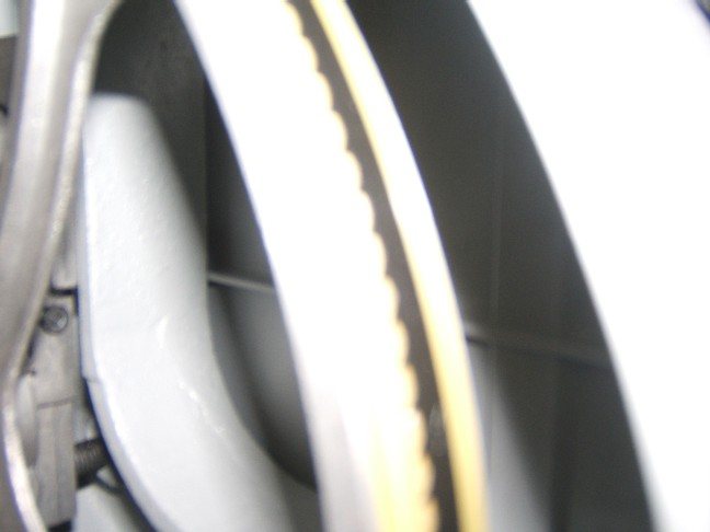

My new bandsaw - BS150LS from Delta - 10" model, doesn't seem to be tracking properly. The knob will move the blade around on the top wheel, but no matter how I move that, the blade stays right on the edge of the bottom wheel, precariously close to falling off. This means that I get wonky cuts, and worse than that, when I tighten the tension up to where I think it should be, it gives a loud 'clang' and jumps off the wheels.
The wheels are a bit unbalanced too, but that's a different matter, I think.
THe blade guards are no where near touching the blade, as I wanted to see if this made a difference...
Any ideas why this is so? I'll upload some pictures so you can see...should I call Delta and talk to them about it, or is it something I can fix myself (on a really new machine)

Lee, I think he could still have a guide bearing problem on the bottom adjustment. His picture of the bottom wheel and the blade makes it look like the blade is closer to center towards the top or middle of the wheel, and running off towards the bottom. SInce he can adjust the top wheel tilt he could be having his blade being pushed out with the bottom backing roller, and with the top guide bearing backed off, he could adjust the top tilt to make the blade run true on top wheel, but off on bottom wheel. If he cuts the wood like you suggested (great idea) and establishes that the wheels are true co-planer, then this is almost for sure his problem. It wouldn't take long to back off the rear bearing behind the blade on the bottom quite a bit, and see if the blade moves back towards center.

Rob, the picture's just at a bad angle - it's running on the edge on the whole bottom wheel. Also, I had already backed the thrust bearings and guide bearings off, so they're not touching at all (thrust bearings are a good half inch behind the blade)
So my guess is that the bottom wheel needs to be spaced out a bit more! Somehow!
