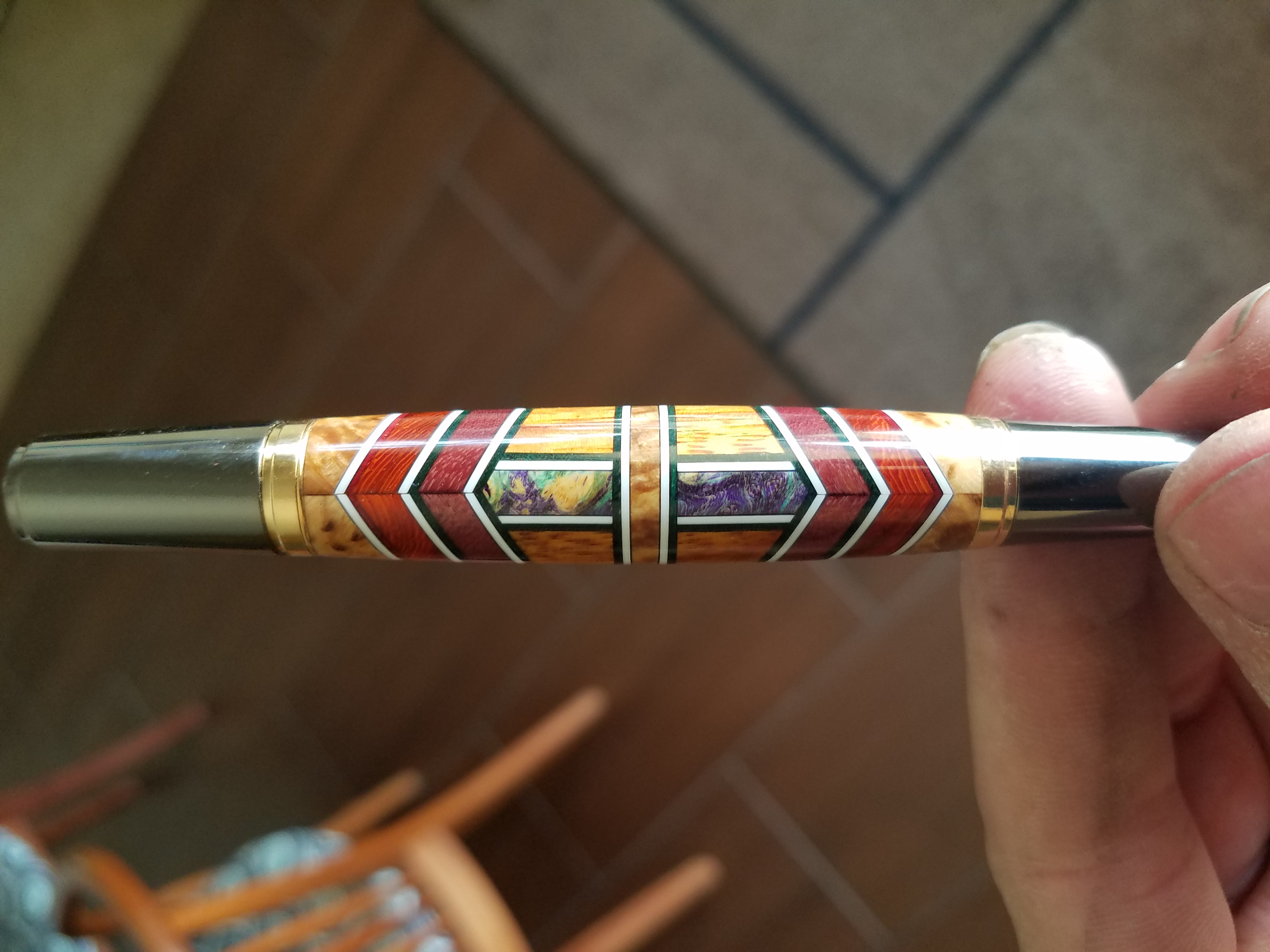

I do segmenting work and I have shown many samples of my work here so I am not talking out my hat. I do not have a Byrnes saw which I think is overpriced and for people who have money to burn. I do segmenting on a contractor style 10" Deltas saw and I use jigs. I also do alot of segmenting on my lathe and the use of a router which I have shown here many times.

My choice is the bandsaw. Mine cuts cleanly with no ridges. Thinner kerf. IMHO, safer than a table saw. And, for clean cutting on the table saw you need a really good blade. Those usually start at $50.00 and go up, way up. For me, safety is a huge consideration. Personally, I shy away from getting my fingers close to a table saw blade and that is what is required for cutting tiny pieces for a segmented pen blank. Bandsaw vote here.
View in Gallery
