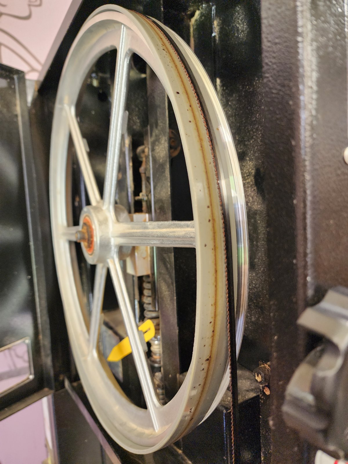

So I have a 17" grizzly bandsaw. I never had any problems with it in west tx. Since we moved back here to E.Tx., I've used it a few times but the last couple times I've tried to cut wood, the blade keeps coming off the wheels. The rubber ring under the blade is sliding off also. I have rechecked and adjusted my stopper and guide wheels and checked tension. I have maybe 1/4" slack. I even bumped the tension just a little but the blade still keeps coming off. Any suggestions?

So I recentered the gullet on the wheel. 10 seconds of running and this happens.
A couple things. First get rid of those tires. Grizzly had problems with their original urethane tires for some time. The tire should never ever slide right off. Unless there is tremendous heat built up because of blade slippage.. If blade is slipping then tires are not doing their job. I never did like urethane tires. I prefer rubber tires. Those look pretty thick and flat. A tire should have a crown to it. I understand the Blue Max urethane tire works well with that saw. I have no experience. There is and always will be one of those old adages you do not need to glue urethane tires on but others say different. They should be proper size and and when installed may need a little heat to install them. Then you know they are correct. You could try gluing them but to me I would replace them before buying new blade.
The next thing it is important the wheels are parallel to begin the tune up. The blade could have an offset in it from prior use or from heat because of slippage on tires so you may need to replace it as well. This is correct to center blade on tire with the back of the gullets in the center. yes on no flutter. Those gauges on bandsaws are only guides. Alexe's tutorial is very good. Those 1/4" blades and smaller are not easy blades to use and keep running true on large saws like that. Good luck. My two cents.
So, sometimes the tires are bonded to the wheel. I can't tell if I am seeing and old bead of glue on the wheel there? Does it look like the previous bond has broken? It might just take rebonding the tire to the wheel, to keep it in place.

Once you have a good handle on how the flutter method is done, I think you'll be able to dial it in pretty readily. That tire, though...popping off like that, is kind of crazy. I don't know if that particular brand of bandsaw is one where you usually glue the tier in place or not, but its worth checking if it is and doing so if required.
Ok, so I washed my tires. The blade is staying on but I haven't applied any pressure like a cutting a board yet. I'm watch my blade and it's straight for a few seconds, then flutters a little, then straightens up again and flutters again. Maybe a bad blade. I have a spare blade that was new but is rusty now from when I had my tools in storage for a year and a half. Not sure if I can trust that blade now.

That said, I do tend to think a couple of the other posters could be on to something and you ought to think about replacing the tires. I wonder if the existing ones have a little slack in them and they are part of the problem. I replaced mine a while back and it has definitely helped my machine. You might need to clean the wheel with a little denatured alcohol or something before installing new ones too. Your photo makes me think the tire wants to slip when under pressure for tension and cutting together.

You won't regret it. It is one of those things that gets overlooked many times. The big thing about rubber tires and urethane tires is basically the ease to clean. Hard plastic is easier to clean because with rubber bits of saw dust can become embedded,. There are 2 sides to which is better but new ones will make a difference.

So I decided to update my bandsaw dilemma. I had an old guy buy an old craftsman lathe I had. Got to talking and found out he used to be a high school shop teacher. I mentioned the trouble with my bandsaw. He said back in the day, they would just take the tires off and turn them around. I haven't gotten spare tires yet so I thought I would try it. Turned the tires around and reset all my guides. Bandsaw working just fine now. I still plan on getting a spare set of tires but at least my bandsaw is up and running now.
Not that I do not believe it works but my first thought is two fold. One is if they are rubber tires they would have glue on the back side or should anyway. Second is the tire should have a crown in them. Even if they were not glued then the crown is now facing toward the wheel and it will throw the tire off balance. Highly suggest get new tires soon or else you could wear bearings and your cuts will not be accurate. Weather you use the plastic or rubber tires, each has pros and cons but still need to be crowned. Good luck.
When I took the tires off John, there was no signs that either one of them had glue on them. I bought this new from grizzly, so it's never been messed with. It seems to run pretty smooth right now. I actually barely use this bandsaw. The majority of my cutting is on my table saw. I still plan on getting new tires and changing the blade tho'.
