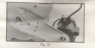

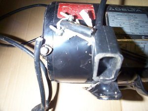

The band saw I have is a model 28-245 and you will see in the pic there are two coated wires coming out of the motor.
1) the power cord
2) a cord that runs from the motor to the saws off and on switch
The motor I bought is a 3/4 h.p. but turns in the wrong direction.
This is a very clear pic...
John, the motor direction is no problem. Simply swap EITHER the capacitor wires OR the motor wires around at the terminals in the motor.[;)]
