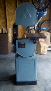

I have been looking for a good band saw on Craig's list for a while. I was looking at a 1981 Delta ($250) that was about 1.5 hours drive from my house. I had not had the time to get out there when this Delta 28-203 showed up. The guy was charging $175 and he would deliver it. How could I go wrong? :)
I expected all kinds of problems at $175. It runs so smooth and quiet. I think it might need new tires but I am not sure how to tell. I definitely will be replacing the blocks and will need to either clean or replace the bearings.
Another surprise about this was the 1 HP motor. I thought they all came with 3/4 HP so I was really happy for that. I plan on adding a riser block.

Thanks for any help!! Here is a pic. I am pretty happy with it so far.

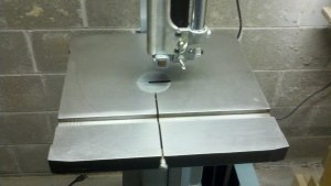

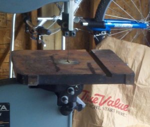

Thanks for all the great advice guys. I was really appreciate it. I think that the reason the guy sold it for so cheap was the table. If you can see the before picture below it looks rusty and hopeless.
1/2 can of WD-40, some scotch brite pads, and a palm sander later you can see the after picture. I think it looks better than I could have hoped.
Before:
After:
