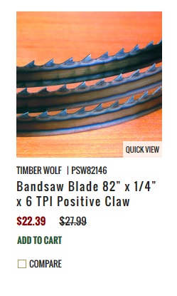

Woodcraft's "sale" price ....

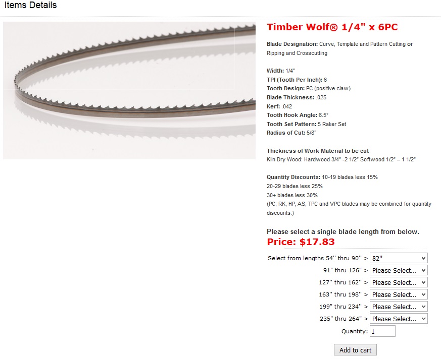

Price for the exact same blade direct from Timber Wolf ....
attachment.php
Seriously, they tacked on an extra 10 dollars in overhead, and for their "sale" they took 5 dollars off.
And notice, if I order 10 or more blades direct from Timber Wolf, they'll knock off an extra 15% or more off the total ... THAT's a SALE.

OK ... rant over, sorry Edgar .... that just really ticks me off, to see companies take advantage of people like that.
I realize that Woodcraft has a right to make a profit on their sales, but seriously ... that's kinda rediculous.
