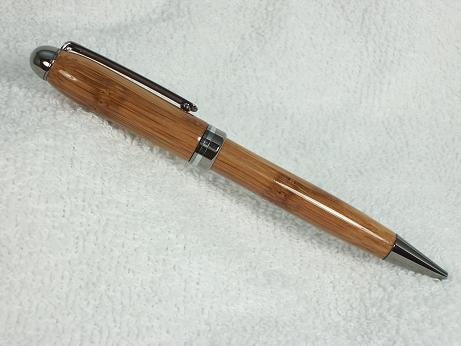

This pen was made from Bamboo. CSUSA wants 3.50 for a 3/4 X 3/4 X 5 blank. I found a small cutting board 5/8 inch thick for $3.99. I can get about 12 blanks out of it. This pen is a Blank Titanium European from WC with a CA finish.
What do ya think?
Thanks
Mike
I really like it! The kit looks really good with it, a little bulbus at the top near the finial, but that's a problem with that kit. The color is much better than most of the bamboo pens I've seen and the joints look good too. Where did you get the cutting board or do you plan on cornering the market on this? [;)]
Looks like the tip is a little proud of the lower barrel. Wood and finish very nice.
Thanks for the feedback. The lower barrel was a little over turned at the nib. I was suprised my photos could pick that up. I have finally found setting and lighting that give decent photos. I actually had to go and look at the pen again to confirm what is seen in the photo.
