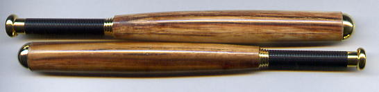

I have a couple of the UK kits on hand. The tubes are smaller then 7mm so I had to make my own mandrel. The first ones I turned I just made a hardwood wood plug for the ends of the tube and turned it between centers using calipers to measure the finished size. I bought my kits in a bulk buy from a friend getting out of the pen making hobby. The pen refills are very poor quality and the refill tips are MUCH smaller then the standard sizes. I had to drill out the kit nibs to except the replacement refills (old ones had dried out). All that being said, what is your address and I will mail you a kit, I have 3 or 4 left over. Here are 2 I made a few weeks back for a friend made from blackgum.
