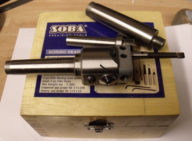

Fragile material and especially segmented pen blanks can IMO be more safely 'drilled' by using a boring head instead of a drill bit. It doesn't get warm ( let alone hot ) and you can sneak up on the exact size you want. So even though it may cost more than a drill bit, it's size range is infinite ( well, upto 38mm dia for my one ):biggrin:

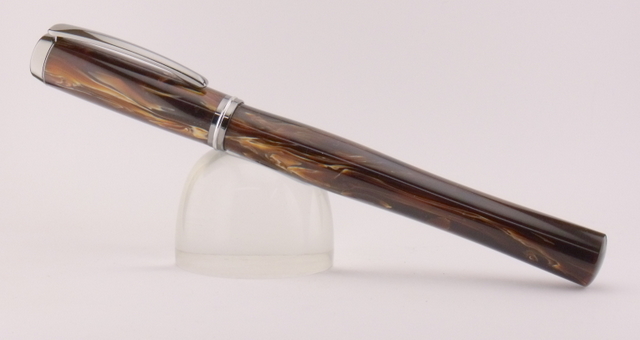

Beautiful pen Skippy. And I have to check out your boring head tool, not familiar with this type of 'toy' especially if it is effective with segmented blanks.
I'm not sure that you can effectively use a boring head on a wood lathe, I thought they required the slides and what not that are found on metal lathes.
Has anyone used one on a wood lathe? There are several things that I think would be considerably easier to do with one.
:confused: If you can drill on a wood lathe then you can use a boring head on a wood lathe. If you think you can't do something, then you probably won't be able to do it.
My boring head works just fine in my wood lathe AND in my metal lathe AND in my drill press. It doesn't need any slides or what not.
Oh, AND it works just fine as an offset tailstock centre for taper turning too. :wink: When I get a chance, I'll make it do other stuff too. :biggrin:
I'm glad I posted that comment, I thought that boring heads were fixed and that it could only be advanced with the tail stock and required a slide for the lateral adjustment. Now that I see the lateral adjustment is in the boring head I see how it can be used in a wood lathe, and it is the perfect solution to something I have not been able to figure out how to do. Thanks Skip!
