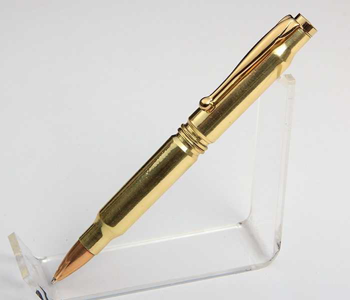

I had a customer request some pens made from back-to-back rifle shellcases. His requirements were:
  1. both shellcases must be 7.62x51mm NATO caliber;
  2. the nosecone must be a real bullet; and
  3. no centerband.
I imposed the additional requirements:
  • the bullet must be seated to SAAMI specs (in order to look real), and
  • the Cross-style refill cannot be modified (so it can be replaced by the owner).
Normally, I make back-to-back shellcase pens with a 30-06 Sprg cartridge lower barrel, and a 308 Win shellcase upper barrel. I find that combination of calibers works well. The above requirements, however, necessitated some design changes.

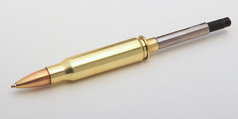

This photo shows how I make my 7.62 NATO (and 308 Win) cartridge pens:
attachment.php

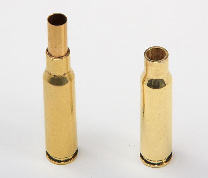

With a bullet seated to the correct overall length, the cartridge is too short to take a stock Cross-style refill. Many people overcome this hurdle by either
  1. seating the bullet about 3/16" long, or
  2. shortening the refill.
My personal requirements above, however, prohibit these approaches. My solution is to solder in the brass tube with about 3/16" protruding from the case head. I press the transmission into that. When turning an upper barrel from wood or plastic, I simply recess the tube by a corresponding amount.
When I use a 30-06 cartridge for the lower barrel, the tube is soldered flush with the case head, as is the 308 upper barrel. There is a gap between the tube and the case mouth (at the finial end), which I typically fill with a piece of shrink tube (applied before soldering). I couldn't do that this time. The upper barrel tube has to be recessed.
So, I needed to solder at the case mouth instead. Solder won't fill the gap, though, so I had to come up with something else. I wound up using a slimline centerband. I reamed it out with a letter "E" reamer; soldered the centerband to a brass tube at the appropriate location; turned the centerband down to the correct diameter; soldered the tube to the case mouth; and then trimmed it to length. Now the upper and lower barrels will meet.

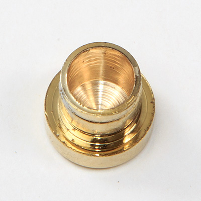

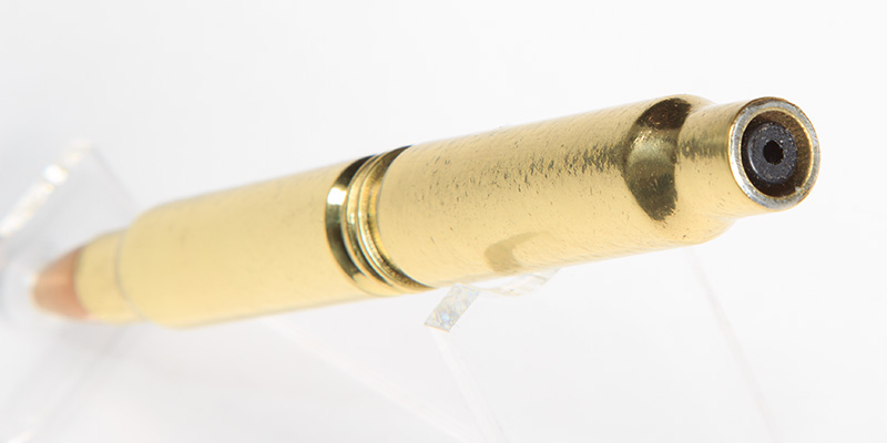

attachment.php
When retracted, the refill sits nearly flush with the upper barrel case mouth. There's no room to press in the finial. I solved that issue by reverse-mounting the finial in a collet chuck and drilling a recess for the refill:
attachment.php

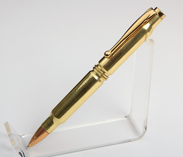

Now the parts all work together when assembled. The finished pens look like this:
attachment.php
And the customer is happy.

Some additional pics
When I first posted, I couldn't find all the in-progress pics I took. I've since uncovered them so here they are:

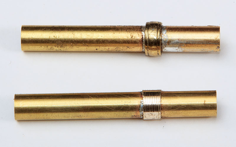

This photo shows a slimline centerband soldered on a 7mm tube, and one turned down to the case neck inside diameter:
attachment.php
Here is a picture of the above tube fit into the shellcase, and one with the tube soldered in and the excess trimmed off:
attachment.php

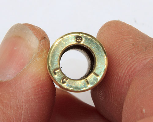

And finally, here is a shot from the case head end, showing that the tube is recessed about 1/4" up into the shellcase:
attachment.php
