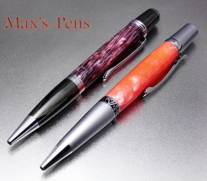

it amazes me that the back painting of a blank can make such a difference. i knew it and have haeard others talking abouit but had not personally noticed yet. well today i completed the second of 2 pens with the same blank just painted differently. NOw i know that even the same color commercial balnks will vary a little bit, but these two were very close out of the bag. they are both Woodcraft abalone blanks. the click pen was back painted and tube painted blask. the regular cigar was back painted and tubes painted white. there difference is amazing. take a look.
Painted black
Painted white
Pens Look Great by the way, It's amazing what different shades of back painting will do to a blank this is the same blank painted white and black

We are painting the wall of the hole drilled in the blank. Painting the "hole" will keep the brass tube from showing through the acrylic once it is turned thin for the pen. Just painting the tube will allow glue to show between the blank and the tube. Some paint both the hole and the tube and even color the glue if using two part epoxy. Personally, I think back painting the "hole" is enough and works well for me.
