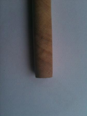

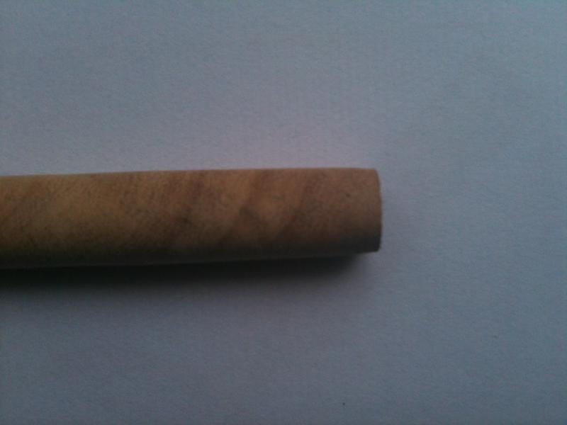

I tried some more olive wood tonight and although the dark specks are less than before they're still there. They appear before I sand so they must be caused by the tool which I cleaned before I applied to the work. Furthermore I cannot remove the specks and they seem particularly ingrained, mineral spirits does nothing to remove them.
Attached are photos. The photo is as clear as I could get it and it shows the right side of the barrel that has some streaks at right angles to the darker grain. I have not been able to get rid of the streaks and I've tried mineral spirits and sanding.

Photos are too dark for me to be able to use -- and I get pixelation when I zoom in in Photoshop. Someone else may be able to see more.
Odds of filing being caused by either a high speed steel or carbide tools shedding particles is small -- especially if you wiped the tool off. Hard tough tool edges do not shed many particles of metal/carbide.
So where else in your system can the contamination be coming from??
Dark sand paper??
You are using bushings??
Soft steel from bushings can migrate if you are getting a bit close and turning steel swarf.
I apologise for the photos, they are a bit clearer on the phone but when I try to upload they are significantly compressed and that makes seeing the detail more difficult. It can't be the sandpaper as I didn't sand the barrels and the marks are still there. I do use steel bushings but I'm fairly careful when I use my tools not to hit the bushings. Still suspect the tool and maybe it isn't as clean as I think but I now clean them with mineral spirits and this staining only seems to occur when I use the skew and I try and rub the bevel to get a nice finishing cut.
I can now only assume that there was a small amount of honing compound/dirt on the tool and that is what the stains are, it has to be as it occurred before I started sanding. I kept going with the skew but could not get rid of the stains. It seems that the dirt got into the pores of the wood and went very deep into the blank, nothing removed it, not the air compressor, not mineral spirits, nothing. Not sure what to do if this occurred again, can you use sanding sealer before making the final skimming cuts preceding sanding?
