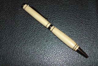

Slimline made from branch wood from Australian Bottlebrush Tree in garden. Drilled & turned wet. Tubes inserted turned to slightly above required size left to dry 24hours.

Not too shabby. That's a dangerous game you're playing turning it wet. Even if it doesn't crack, you're still going to throw off the diameter so now you're nib, centerband and finial are all going to fit differently when dry.
Interesting first time see a Callistemon so white I know isa light colored wood but not like this ,
les-smith we do have Holly to here but not as white as in the States, our is more greyish
