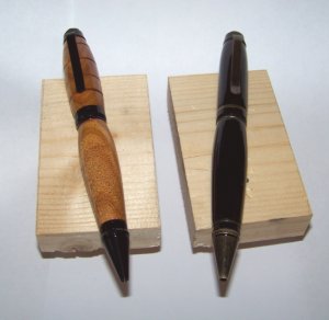

Yes I do realize that as it tells me on the product label. :) But being able to apply another coat after 30 minutes is better than 3-4 hours. I am well aware of the 24 hours for it to cure. Below are pictures of the two pens I dipped and set. I had no issues with collection at the bottom of the blanks. In the ebony pen you will see something to the right of the pen, that is a nail through the wood it is sitting on. Both pens dried for 24 hours using the poly. I am not looking for a quick way for the end result, sorry if that was the impressions people got, what I am looking for is something that is less hassle for me personally. That is why there are different methods because some people like one method better than the other. For me I like the quickness of the CA but there imo are too many variables for me personally to get it to work the way I want it to. That's just how I am. Who knows I might go back to that, but I am liking my results here. Thank you to everyone for all the tips and suggestions on both methods.
