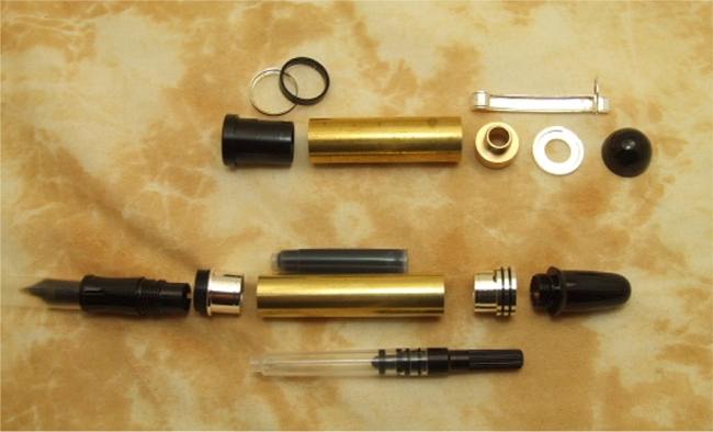

hello all. i am making my first churchill for a friend and want to get this right. the directions i have from berea is a bit confusing especially since they don't have an exploded view of just the churchill.
anyone have a more clearer set of directions that they would be glad to share with me? i'll be forever in your debt
Hughbie, I had to reply, I have never ever been in someone's forever debt ! [:p]
Here you go, does this help.
<br />
I will be thinking of my 3 wishes or whatever comes with a forever debt [:D] Good luck on the Churchill
i bow to the great and wonderful 'Anthony'. thanx. that's just what i was needing.......such a simple task........it doesn't quite warrent 'forever' in debt.......does it? [:I]

Now the big thing with these is make SURE you drill a "press block" that will protect the threads and press on the silver ring only. I like to use Corian scrap myself. I do not think you could even press this kit togather without breaking the thread coupler if you don't use the press block. Good luck, this is my favorite kit.

i want to thank you all. i'm off to try this assemble......maybe i can even figure out what is meant by a press block (a piece drilled to slip over the item that you want to press........ya have to be pretty accruate correct???)
