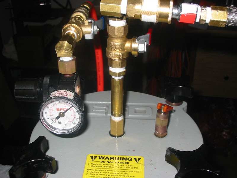

I have my Pressure/Vacuum Chamber (pot) almost completed and hope to order my supplies to be in casting test mode in a few days.
My questions for those of you that are casting currently or have cast in the past:
1. What pressure do/did you find most successful...
2. What duration do/did you require for the cast...
3. And what material(s) were you casting under those criterion...
I can easily maintain 70 PSI and the tank is rated for 100 PSI. I still have a couple of small pressure leak issues to resolve but I get 20-30 minutes of 70 PSI before the compressor cycles back on. I am trying to see if I have an acceptable pressure system currently, just in case I cannot get the remaining leaks closed in a timely/affordable fashion.

I did the soap bubble search and the main leak(s) are in the lid o-ring. I pulled the lid and the o-ring has noticeably "flattened out" some in a couple of spots and the prospects of removing and replacing are not something I look forward to. The small leak in the regulator knob is minor and can be cured with a replacement.
So, I have to decide if I want to remove and replace the lid o-ring, which, I fear, can cause more problems than I have right now, or use it as is for a while and postpone the o-ring.
Anyone replaced a 9" diameter recessed o-ring????

Well... like I feared, the Vacuum Leak Test yielded significant issues.
I can pull a full vacuum and hold it indefinitely (which means the vacuum reservoirs and lines leading to the chamber are working 100%), however, once the vacuum line ball valve to the canister is opened, I lose vacuum rapidly (about 2 Hg within a couple of minutes), and the vacuum pump cycles back on.
Now that is not a big issue if I only need the vacuum for a few minutes and then switch off the vacuum ball valve and open the pressure ball valve and pressurize the casting. If I need the vacuum for a much longer time-frame, then I will have to isolate the leaks and make repairs.

I had the same problem with my new HF pot. No matter how tight I tightened the bolts, it would still leak at the lid seal. I was about to take it back and decided to try something first. I sprayed the entire rubber seal with WD-40 and put the lid back on and tightened it down. I let it sit overnight and it has held perfect every since! Don't know why since I would not think that WD-40 would soften the rubber but it did something. I pressure my pot up and then I have a valve that I cut off and remove the hose. It will hold 60 psi for at least 24 hours (longest I have tested it) without loosing any.
I also have a second pot that the seal kept blowing out on. I would pressure the pot up and the o-ring would actually bulge out and blow all the pressure. I never could get it to work correct. I ended up removing the seal and filling the space where it was with some butyl rubber sealant (caulk) found at the local BORG. I let it skin over until it was no longer sticky but still somewhat soft. I then put some grease on the top edge of the pot and gently set the lid on the pot. I let it sit there overnight and the next day I had a custom fitted seal that will also hold 60 psi for 24 hrs!!
If you do this, I would suggest putting some alignment marks on the pot and the lid so you get the same orientation each time. I actually did that with both of my pots.
I had a HF pressure pot that would not hold a seal also. I just gunked Vaseline all over the seal......tightened it down and tested it overnight. It works like a champ now. It may have conditioned the seal.....or it was pure magic.....but it worked for me.[:D] [:D]
