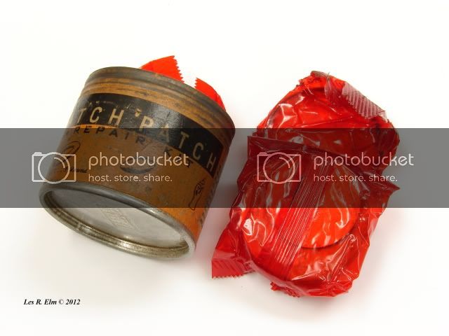

Using these?
If you are, how did they work?

If those are hot patches for innertubes, yes they worked. There were a variety of them in use, some used rubber glue which was set on fire and then the patch was rolled onto the tube while still hot, some had a jig/clamp that held the kit in place while a heating thing was set on fire that vulcanized the patch to the tube. Each brand had their own quirk to make it work better than the competition. Of course, none of the above is correct if those are not patches.

I fixed many a flat tire with those back in the late '50's, and early '60's. The cap on the can was perforated, and you would use that to scuff up the inner tube. Then you would put glue on the scuffed area, and put one of the patches on it. I only used it on bike tires.

I remember them I think, I used to watch the owner of the Atlantic Richfield gas station fix tires with them, there is a rubber patch stuck to a metal like shallow cup, and you clamped it to the spot on the tire or tube you wanted to fix and the shallow cup had like a phosphorous like material in it, you dug your knife blade into it and pulled a little bit up and put a match to it and it burnt real hot and bright and fast and it melted the rubber patch to the tire or tube, If I remember right, but that has been 55 or 60 years ago

That's what I could not remember Charles, Vulcanize patches.
I never used those particular ones, because they were for automobiles only. These contained a thin metal piece in each vulcanized patch to strengthen auto tires.
I patched many a bicycle tube with those. I can still remember the smell of the smoke as they burned. I never had one of those hot patches fail.
