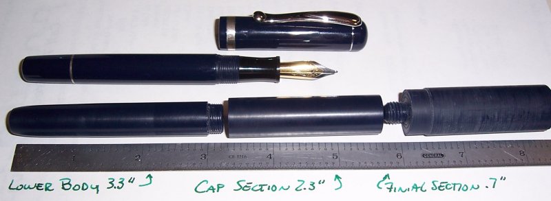

Guys,
what blank length do you use for kitless fountain pens?
Some vendors have only 5" blanks.
Do you think that 5" might be a bit too short for kitless?
What's the optimal kitless blank length?
Thanks,
Alex

Guys,
Thanks,
Alex
I have made several pens without kits and have found that it really doesn't make any difference and lord knows I've used both lengths quite a few times trying to save a dollar here or there. After a while you will find that you have a box of cut offs that you can use to make other pens so their really isn't a lot of waste either way and in my mind not enough to justify the higher prices some charge for the longer blanks.
Actually I prefer using longer rods because I can cut off exactly what I need then put the rod back on the shelf rather than dealing with all the short cutoff pieces. This becomes more crucial when working with materials such as ebonite which are sold by the inch!
Here is a shot showing three sections of a pen in-work and what a similar pen would look like finished to give you an idea. Notice that a 6" blank would not make a complete pen using a screw on finial so you would end up using a chunk of another blank anyway.
My lower sections are usually around 3+" while the completed cap is around 2.6" depending on which nib I use and whether it's a rollerball or fountain and how I hide the clip.
Hope this helps some.
