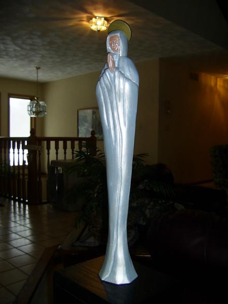

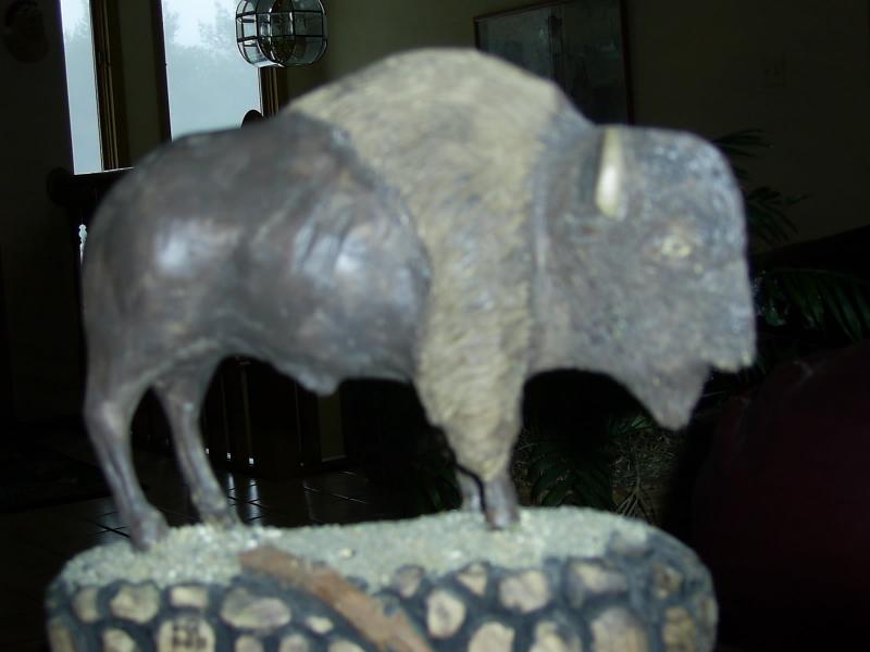

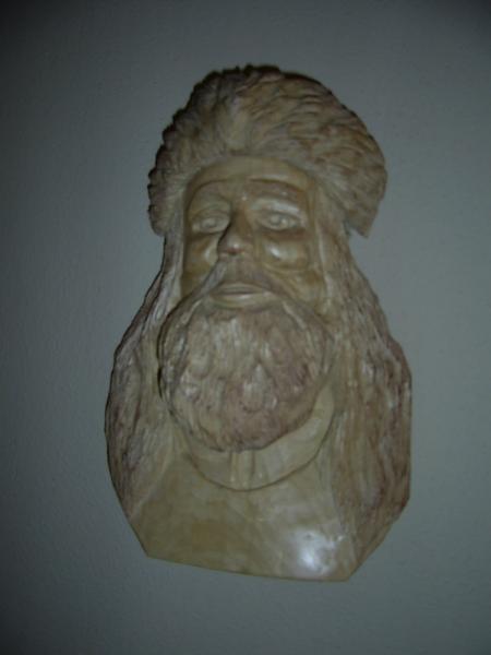

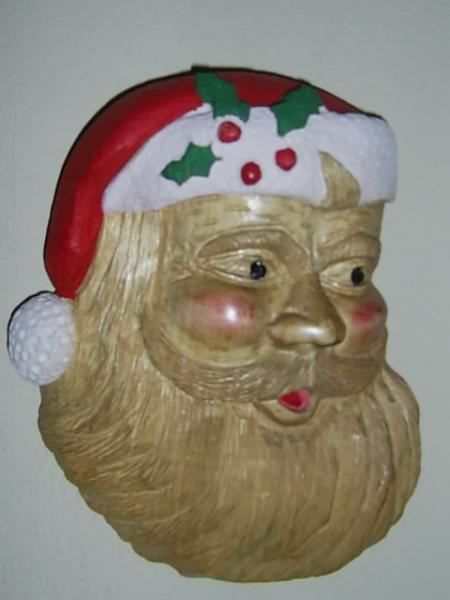

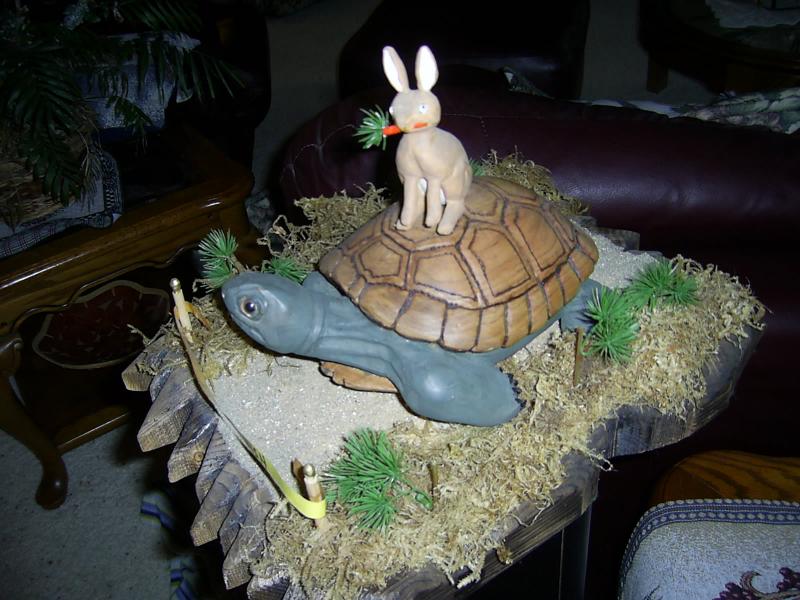

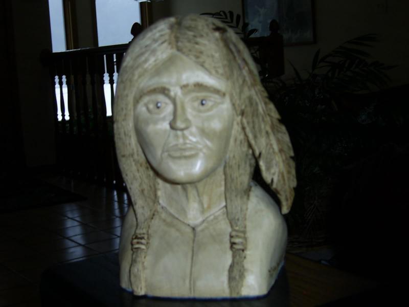

I fine this very interesting regarding DNA, when i was learning how to wood carve my master carving teacher use to spray Isophol Alcohol on my wood carving's when we were doing real detail work on eye's, nose,mouth and he always told me by spraying Alcohol on the wood that would tighten the wood fiber, mine you the wood was very dry Kried Dry.
Lovely carving you have shown. A++
I have never tried carving. Don't think I would ever have the time or patience but I love seeing what others have done.
