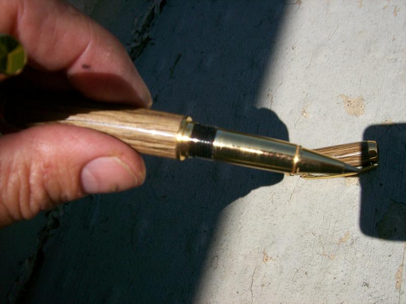

Well after turning 2 and getting ready to photograh I seen this. This reminds me why I dont like 24K Hope the chrome I bought holds up.
Ring scratches on the nib and I tried to polish it with ren wax and you can see by the threads the plating is coming off. This is happening to both I made this morning.
Many capped kits (including the original Jr Gent 1 and Jr Gent 2) also have this problem. I'm pretty sure that a solution has been posted to these forums but I don't remember what it is at this moment.
Steve Thanks I done a search and found
The solution has been to trim some of the plastic from the inside top of the threaded insert before you insert it into the cap .
I dont know if I will try that or send them back. Already have 2 bad ones.
