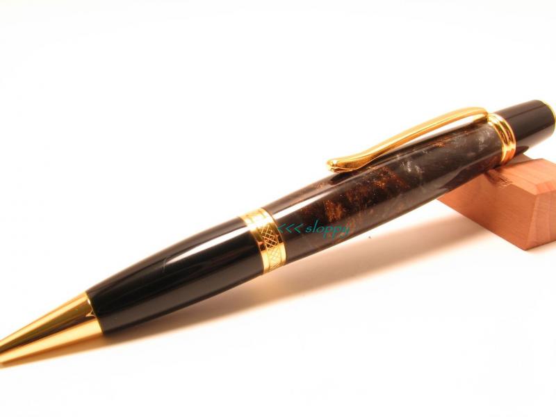

I have put together 10 of these, all of them have play where the nib section butts into the barrel where the bushing butt into while turning .
You can move it around a little which shows the raw edge.
The kits look good I think but are sloppy and not the best design in the world.
