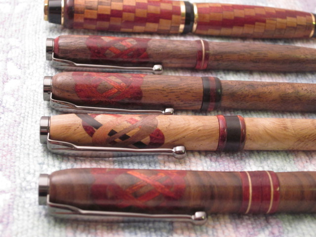

Danny, I use socks. First, the sock has a hole in it-what do you do now? Use a paper cutter or good sizzors and cut the socks into two inch strips cross-ways. A sock is not very thick so some times I put a 1/4 inch strip of some foam insulator inside the sock then my finger is sure not to get hot or worse, burned during the CA and other rubbing applications. Most socks are more coarse at the top and finer near the foot area. I was using a short strip of toilet paper rolled up. That works good but I like the socks better. I use one for CA applications, one sock strip for only EEE cream, a seperate sock strip for french rubbing polish, and keep that with the small applicator bottle 2 inches tall. I use another for wax removal..... Works very good for me....
