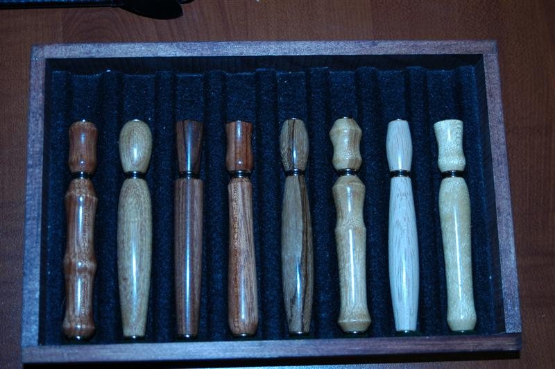

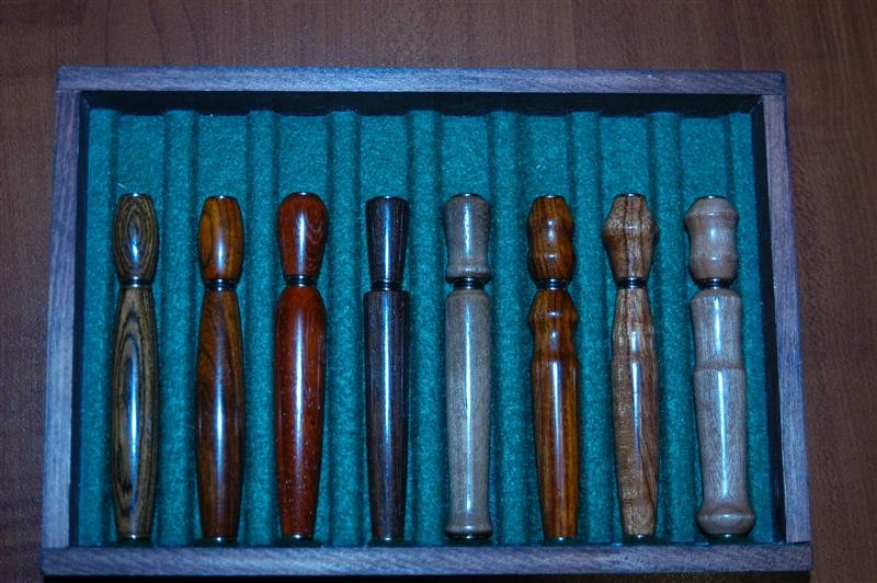

I actually sell many men models. Dark classy wood (cocobolo, walnut, african black...., but with straight fat lines. Very popular with reps and sales person, that have to atemp late meeting and or luch, just have to refresh their cologne. Easyly slip in the breif case. I admit, i had to fight some very nasty remark at the beginning but the idea is slowly making it's path. I'm actually working on a modification, adapting it as a shorter keychain, this should be even better and easier to discretely use but would have to be refill a little more often.
Gregg, here are some idea for you, the second photo, left 3 are some models that men likes. Sorry, just a quick photo of what i have a home now.
