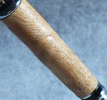

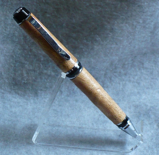

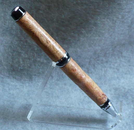

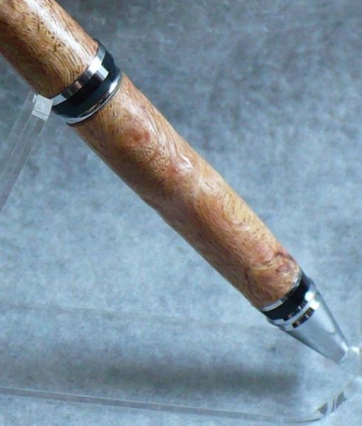

I turned a piece of pine tap root yesterday. I notice it didn't seem to enjoy the heat from sanding, so I got gentle with it. I finished it with 6 coats of CA and all was good last night. When I went to show it to someone this morning it was bumpy and knobby. Did the humidity from a big storm this morning have something to do with this? I know a tap root absorbs water, but the stump has been out of the ground since 2005. I may have discovered an anti-skid wood. Should I add this stuff to the bonfire?

That's pretty strange! a nice looking pen other than the lumpy stuff, it doesn't seem as though a large rise in humidity should do that, not after sanding and sealing the exterior with an acrylic coating, one would think if it were going to do it the CA wouldn't have stuck to the root.
I got finished making it around noon and played with it the rest of the day and it was still smooth last night I love the crazy grain so I have to try another. All together, I have 20 to 30 feet of this stuff.
I love how fine the grain is on top of the craziness. Hope it works out and you just had an anomaly there. Beautiful stuff and I was keenly interested in finding out about taproot as well!
I have never worked pine root, but regular pine is just cram full of pitch. If it is not kiln dried to fix the pitch, it works out for a very long time. It makes tiny little balls on the cut surface of the wood and sticks to everything. The only solvent I know of to cut the stuff is turpentine. That could be the culprit. I would try hearing a piece in an oven, not the one the wife uses, for a week or so at about 125 to 150. Check the drying recommendations to see what the pros do with the stuff. Pine can be real nasty to work with because of the tar.
The timber on the pen is beautiful. Wood like that is worth playing with to make it usable. Your pen is gorgeous.

Yeah, I think what you've got there is wood that wasn't dry at the time of turning...!
Tap-root or any other wood can keep large %'s of moisture even after been cut for years, the best way to deal with it would be to cut it up into pen blanks and let then settle for a while om a well ventilated place but away from sun/weather.
Spacing the blanks and using "separators" in between layers, is the best way to allow air flow through them.
You can also stabilize the wood, not with the type of stabilization used in very soft woods but the one that preserves the wood, like the Fungishield product we have here in Australia.
The wood is too nice not to take those extra steps, the results will be a lot better, you will see...!:wink:
