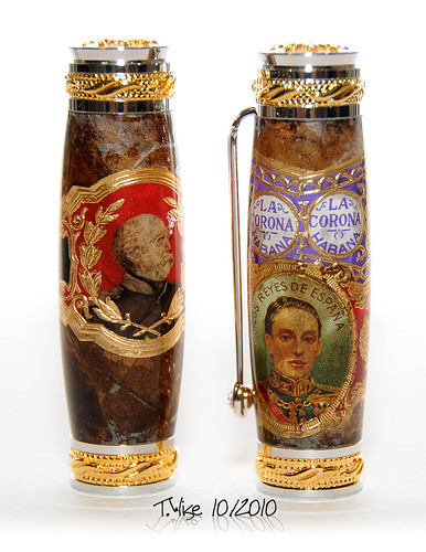

I've wrapped dried tobacco leaves around tubes and poured clear resin around them. It works fine but the finished pen is not very attractive.

I did one out of lentil beans for a chef friend. Pipe tobacco is a bit on the moist side but there shouldn't be a reason it couldn't dry and be cast. As many here demonstrated on a daily basis...anything can be cast...provided you have the nerve!!
i have actually cast tobacco. After the initial turning, there were so many voids that I re-cast the same blank again. It turned out not bad! It came out looking more like a burl.
When I first started turning I tried the whole casting thing as well and one of my first projects was to buy some cheap cigars and pull the leaf off and wrap it on a tube for casting. Now that I know how it works and how to do it correctly I can look back at the failures and move on...so yes, it can be done! I put it on with CA glue, but you can see some casting shine where I think there might have been some moisture or too much CA...who knows.

But, I can imagine an amazing looking tobacco leaf pen - a la snakeskin, fabric, etc blanks.

I grow my own tobacco. The leaves are pretty tough. It is how the leaf is cut that makes it different. Actually cigarette tobacco is a long thin ribbon cut. In most cigarettes it ends up small flakes because it dried out and got broken into pieces. You coudl use a whole leaf and actually roll it onto a pen just like rolling a cigar. You would want to look up how to do it though. part of the trick once again is how the leaf is cut. Also a good cigar leaf is thin and has very small veins. You would want to moisten it to wrap then let it dry out. Your first attempt is not likely to be your best. Otherwise you should be able to work on your technique until it looks like a real cigar should.
