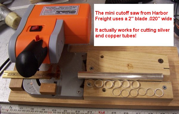

Or get the small cut off saw from H/F I have both and the H/F saw works great it has about a 2" blade. PSI sells one the same as H/F but a higher cost
Hey Butch, that is a neat little chop saw!!!:eek: I wish we had stuff like that here:mad: Can it cut through a 1 inch blank?
I have one, in fact it was on sale $20. It maxs out at about >3/4"< 1". Just be careful to square up the vise/fence holder. For what it is , it works fine.
Max I've found is about 3/4", plus it has a tendency to bog down on blanks if you try to rush the cut.

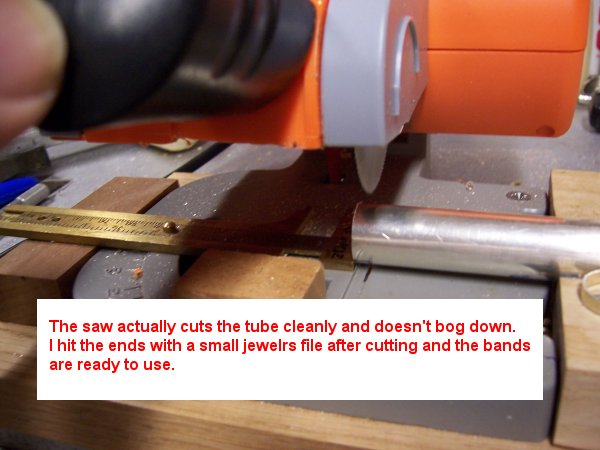

You do have to align the vice to the blade and check it every so often , but it does cut nice straight , square edges . The saw is supposed to cut 3/4" but it really is only good to about 9/16" . The vise has a grove in one of the jaws to align and hold the tube tightly without damaging it .
It is under powered so don't expect to cut solid brass with it but it does cut standard brass tubes very cleanly .

Ditto. Plus it can make the cut edge a little burr if you cut through too fast, but this can be remedied with a deburring tool or file.

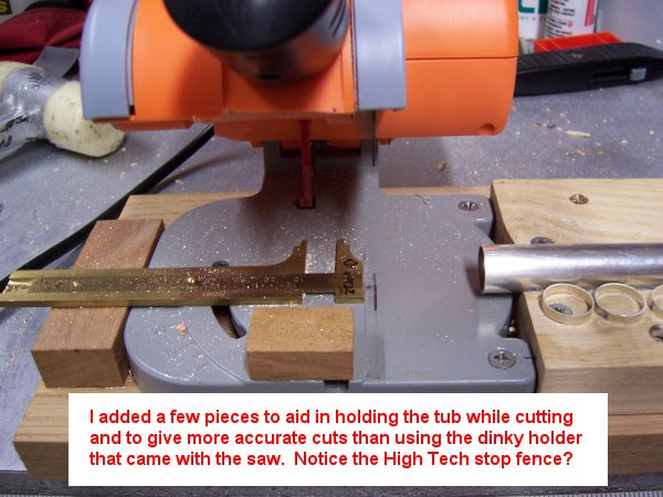

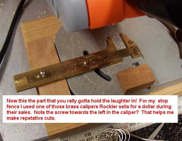

Rose, I also would recommend the little Harbor Freight saw. To give you some ideas, I included a few photos of my setup that I modified last year to make repeat identical thin cuts in tubing.
I threw away their junky little miter table contraption and and made my own tube holder and made a few other mods you probably wouldn't want but these saws can make some very accurate cuts in brass, copper, silver and even titanium (if you don't mind one cut per blade!)
If you still want someone to cut your brass, I'll do it for you but you'de be missing out on the fun!:smile:

Rose, look at my first photo above, see the little red "button" on top of the handle just beyond the black part? Pushing that down with your thumb or finger moves that safety piece underneatn, no need to get your fingers in the way. I assume your's is the same as mine.
