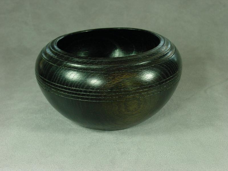

From my experience!
Here is a red oak bowl that was turned green and sanded then let dry. Then a tiny bit of sanding and ebonized with the vinegar/iron solution. Finished with a few coats of Liberon finishing oil, buffed and waxed with renassiance? wax.
The bowel went slightly elliptical when it dried. I do the wet turning and sanding often on my bowls, many people like the elliptical look. When asked how I make them ellipitical, I tell them I'm very fast with my tools!, just kidding:biggrin:
