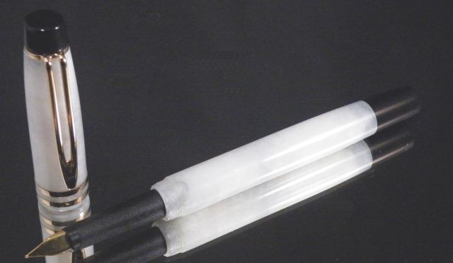

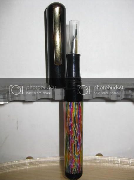

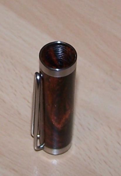

Dan, I tap Dawns PR on a regular basis and I find that if you can incorporate some sort of re-inforcement like a cb then it works fine.
Here is one I did some time ago.

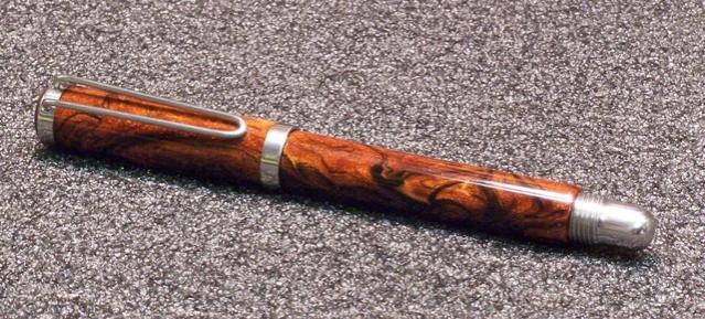

I guess I have been lucky so far , I thread PR all the time and haven't had many problems . I use taps and dies to do all my threading and get nice clean threads , both inside and outside . Like this one
I do try to reinforce the inside threads with some kind of centerband , but even with out the CB I have had good success , like this

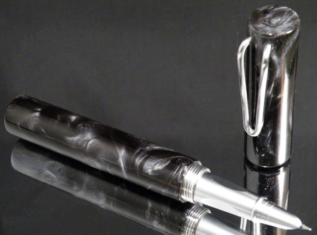

The cap threads on this pen are cut in the PR and a metal threaded coupler threads into them , so far the threads are holding up just fine and these are both pens that I use on a regular basis .
