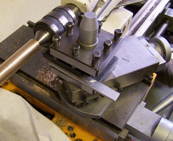

I'm practicing thread cutting on my metal lathe.
It has a METRIC leadscrew ( So I can't release the half nuts )
I have done the first cut for a three start thread. (Using 8tpi)
How do I calculate how much to move the topslide and the cross slide to move the bit for the next thread?

Are you cutting 8 threads per inch or 3 times that?
What angle did you set your compound at? Some people thread at
29-1/2° and some thread at 30°.
No trig should be needed. However you may need to set your compound parallel to the shaft. An 8 tpi has a .125 lead, so you would divide .125 by three (aprox. .0415 would be just half a thou shy, should hurt anything) and move the compound .0415 for each start.
Paul, I thought I needed the compound at 30deg ( 29.5 ) to ensure clean succesive cuts? If I have the compound parralel then won't I be cutting the rhs of the thread groove incorrectly? If it's perfectly ok to set it straight then that would solve my problem. I was contimplating rotating the stock 120deg in the chuck. But that seemed a bit primative. I'm certainly going to give it ( your method )a try now, thanks.

Skiprat, I hope my math is right on this but you should move you compound out .048" and move your cross slide in .024"

I was just eating my supper and the penny dropped on the 30 deg setting. In the pic I have it set 30deg to the base. I think it should be 30 deg to the perpendicular? Don't think it matters too much on these practice runs though ( esp in soft brass )
Skiprat; I think you are correct. It should be 60 degrees to the base. The compound should be parallel to one of the edges of the threading tool. The reason behind the set up is to only cut on one of the thread edges. Use a fish-tail (threading gauge) to verify that the tool is perpendicular to the piece.
30 (or 29.5) degrees off perpendicular sounds correct. The key is that at 30 degrees, turning the compound dial by .010" moves the tool half that amount or .005" At 5.8 degrees, moving the compound by .010" moves the tool by .001" or one-tenth the compound dial measurement.

Actually, probably the easiest way to do this is to use math and geometry from a 30 60 90 triangle.
Picture a 30 60 90 triangle with the short side on the bottom. the 90 deg angle is on the left, and the 60 deg angle is on the right.
The 90 deg angle represents your crosslide, and the 60 deg angle represents your compound.
The bottom of the triange is your pitch.
The side on the left (made by the 90 deg angle) is Pitch times the square root of 3.
The side on the right (made be the 60 deg angle) is 2 times the pitch.
These equations will give you the distances to move the compound and crosslide.
So you will move the compound IN 2(pitch), and the crosslide OUT pitch(sq rt of 3)
OR
Move the compound OUT 2(pitch) and the crosslide IN pitch(sq rt of 3)
