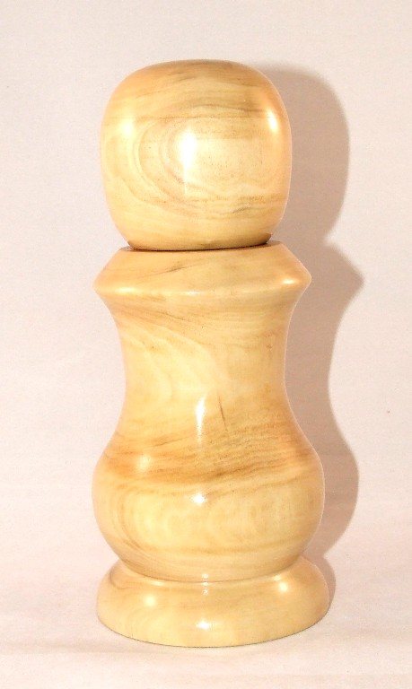

I found a little limb of birch that a beaver had used in his dam.. about 3' long x 5 or 6 in dia... used part of it to make a peppermill.. it's a little plain, but really polished up nicely.
