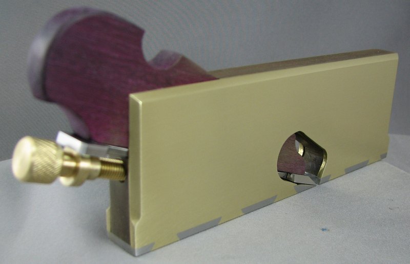

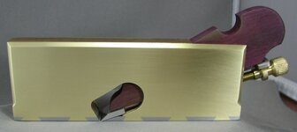

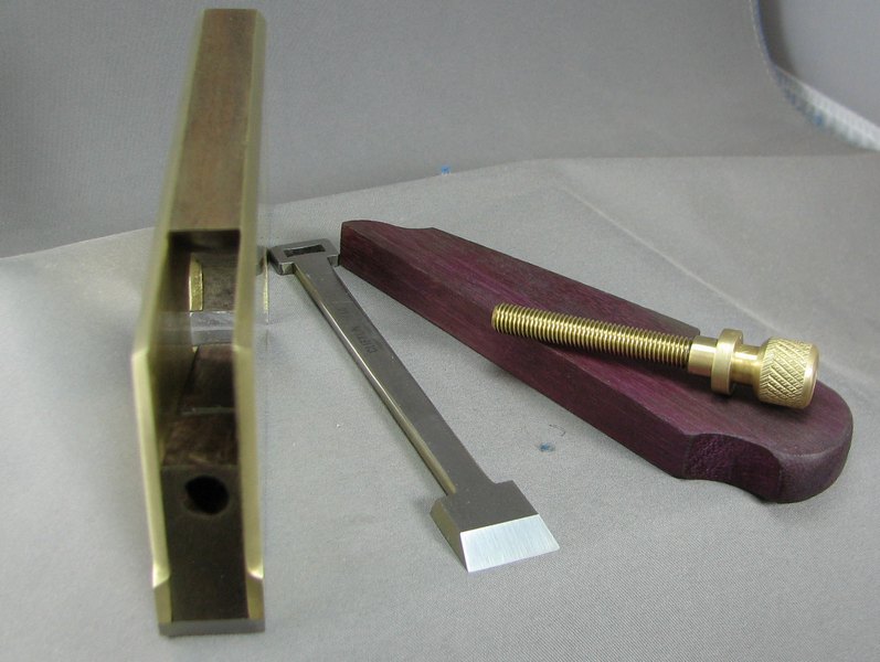

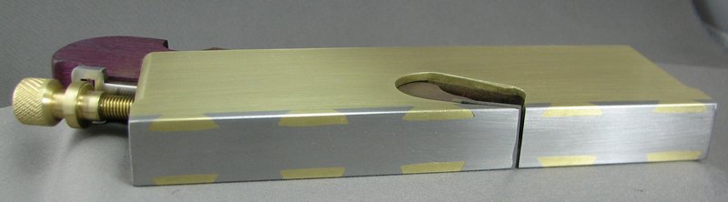

I made a metal one.......
attachment.php
attachment.php
attachment.php
attachment.php
It's a rabbet plane, 11/16" wide and made from brass and steel. The wedge is Purpleheart and the filler is Walnut. I made the brass adjusting screw on my metal lathe so the only "store bought" item is the iron. All the dovetails are cut by hand using a file and then peened over with a hammer.
After all that it took hours of filing and sanding to get the sole perfectly flat.
