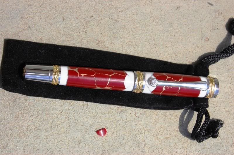

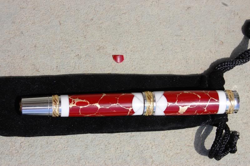

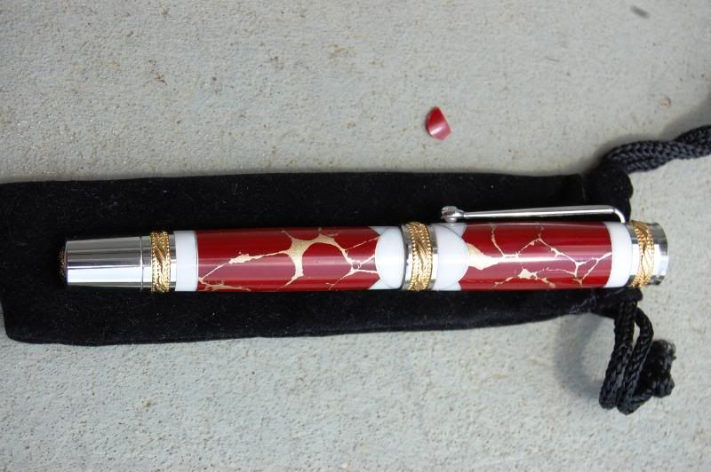

I have over te last couple of days had the misfortune of having to disassembe a Majestic two times. While disassemblingthe first time I chipped a piece of the Tru-Stone blanks off.....No big deal there. I take both barrells and turn a small piece off both and segment a band on them. While assembling the 2nd time I had inadvertantly placed the cap upside down on the threaded end.......you guess pressed to hard and cracked the finish, then I figured out my mistake. The piece that chipped off is laying next to it just for reference.
Does anyone have a better way to disassemble them than a punch set?
here it is after all the mistakes.
That one is excellent! I don't see any flaw with it. It didn't turn out like you wanted, but it is nicely shaped and the colors are good and it looks balanced.

there were only scallops to begin with......then I broke it. This one has the best set of scallops to date.
