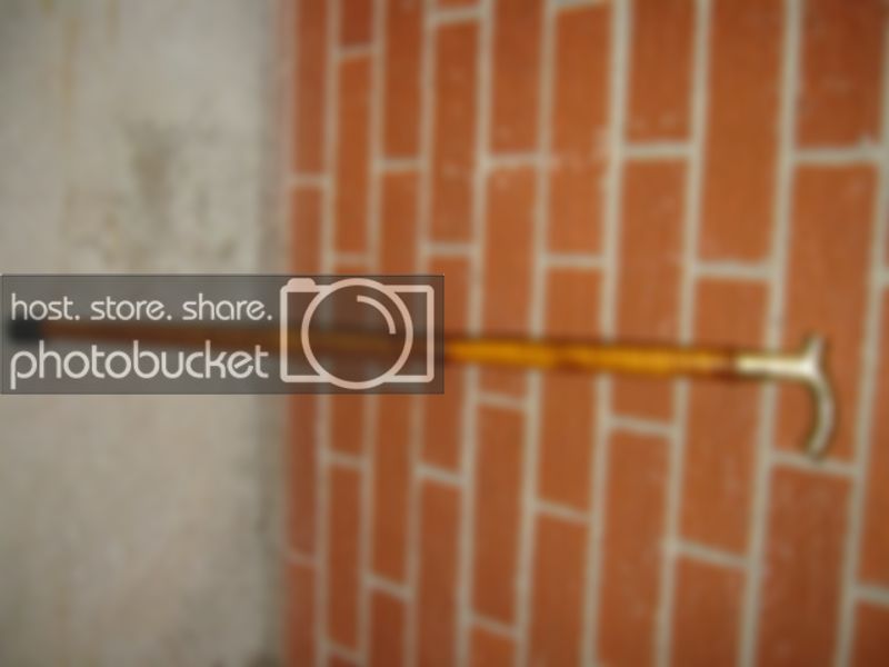

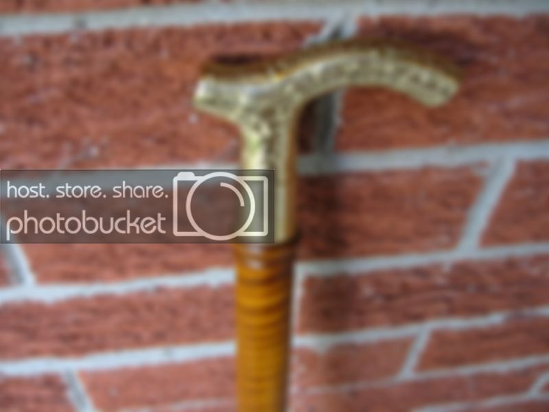

I turned one about a year ago for my BIL. I purchased the couplers from CSUSA and also used their brass cane handle coupler (Item 050-7095) and turned my own handle out of the same wood as the shaft of the cane. I wanted something a bit different so I turned the handle on a total of 3 centers, the first 2 to give the handle an oval cross section, the 3rd center to round out the front section to fit in the coupler.

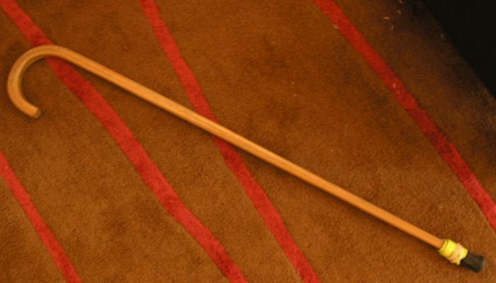

My brother made this one for me about 15 years ago. He laminated thin strips together bent the top around a coffee can and slightly tapered all four sides toward the tip.
That is a reflector on the tip since I use it daily on my walk and the reflector is picked up in traffic headlights. It is mainly used to fend off dogs and bunny rabbits I encounter while walking.

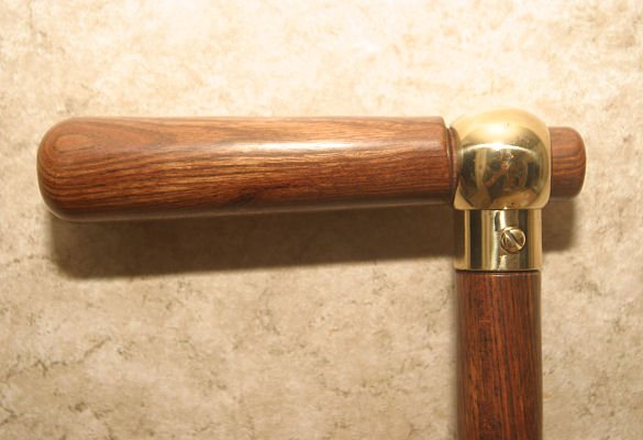

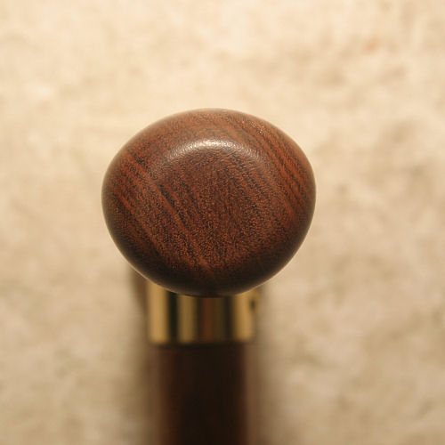

I turn canes for my craft sales, and made one for my own use for my Hip Replacement pre and post op condition.
Here are what mine look like, I buy the handles from LV.
I carved my own from the same wood I turned the cane with. I drilled a 7/8" hole in the handle blank and turned a tenon of the same size for the cane, glued it together and it has been excellent.
