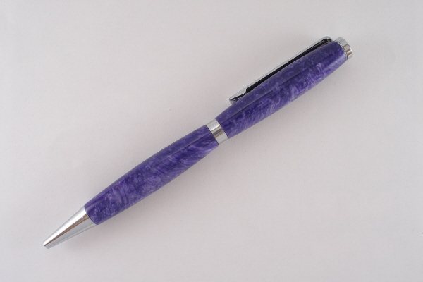

ahoiberg Member Joined Apr 10, 2007 Messages 1,765 Location Ames, IA, USA. Dec 4, 2007 #1 does anyone have any pictures of homebrewed PR with powder coating or mica pigment as a colorant? this other thread has me wondering...
R rlharding Member Joined Nov 20, 2007 Messages 844 Location Nr Vancouver, BC Dec 4, 2007 #2 Check the archives, I believe some have been posted within the last couple of weeks.

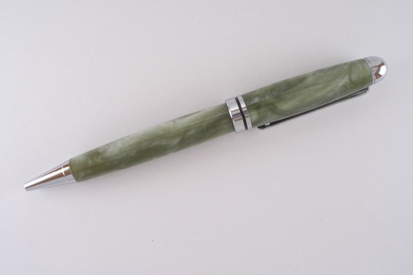

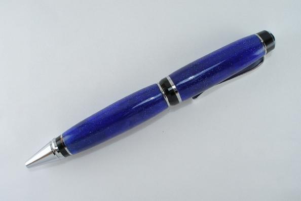

stevers Member Joined Dec 18, 2005 Messages 2,991 Location Bullhead City, Az., USA. Dec 4, 2007 #3 These are all home brew. I'll put a small description with each one. Purple home brew colored with mica powder from Coastal Scents and some pearl color liquid from CastenCraft. Green home brew colored with mica powder from Coastal Scents and some pearl color liquid from CastenCraft. Blue home brew colored with blue mica powder from CS and some glitter type powder thrown in. Hope these examples help you out.

ahoiberg Member Joined Apr 10, 2007 Messages 1,765 Location Ames, IA, USA. Dec 5, 2007 #6 forgot to ask steve, did you need to paint tubes with those colorants?
stevers Member Joined Dec 18, 2005 Messages 2,991 Location Bullhead City, Az., USA. Dec 5, 2007 #7 No. The dyes I got are opaque. The liquid I have from CastenCreaft is transparent and the tubes must be painted. Like the cactus pens on my web site.
