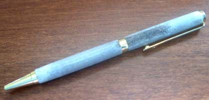

Well here it is.
My first antler turn.
Photo quality not so good but you can see the pen.
This stuff is wicked hard. I used a full AO saftey mask
(that my wife uses for glass bead making)and had no problem with the smell. Drilling was interesting too.
This is only my seventh pen. I plan to make more from anter.
Thanks to all for the info.
Steve
<br />
Nice turning, Steve. Is that a digital camera you're using? If it is, then it looks like your white balance setting might be off.
