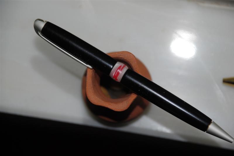

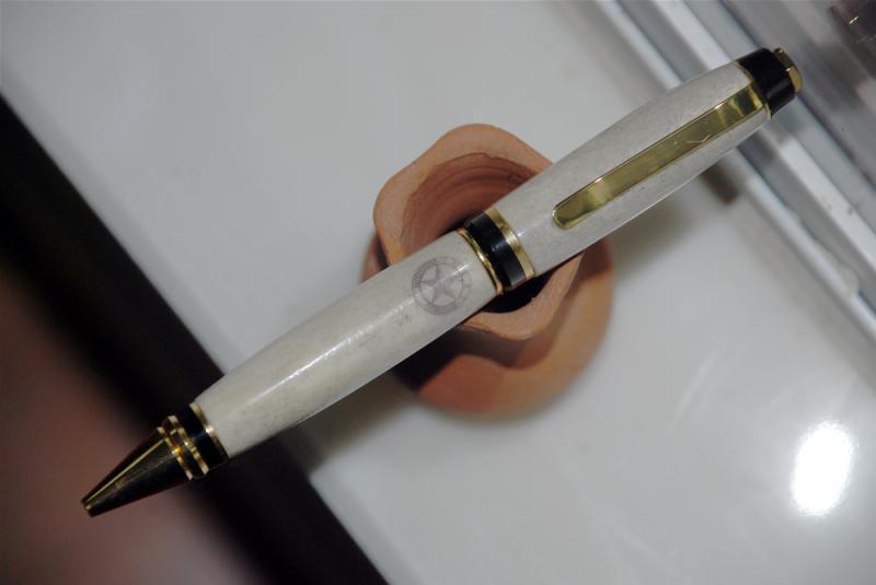

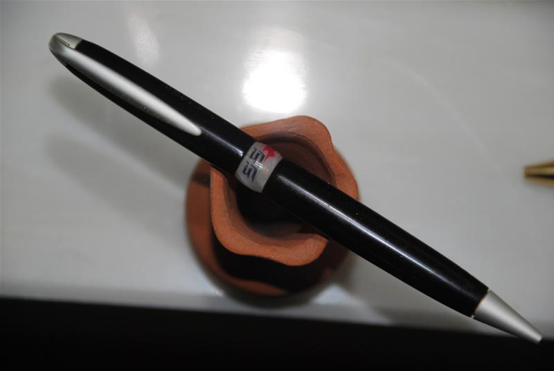

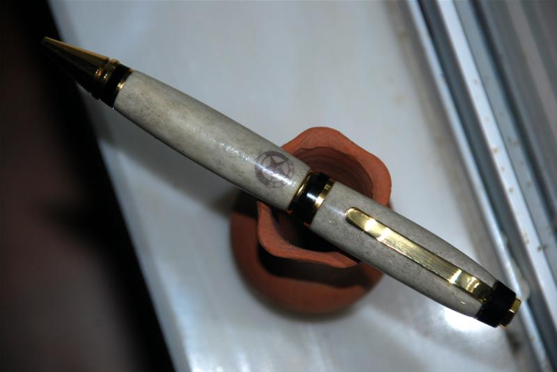

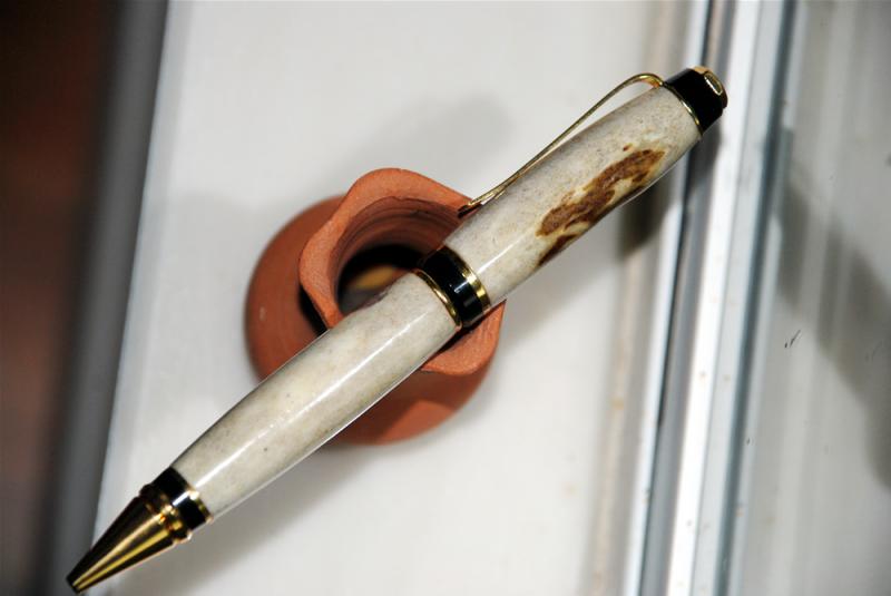

Playing around with decals a little. I think the finish is good but not as shiny as I like it.
Looks good... i want to try the decals myself...more worried about getting them right on the printer than on the pen lol...I love the centerband on pen#2 very nice...

Nice pens. The black pen looks like the nib is not press in all the way.
Aha, you caught that. When I squared the pen it went too far exposing too much brass. I did not have the foresight to file it off. I was also concerned about the size of the barrel had I cut it off.
