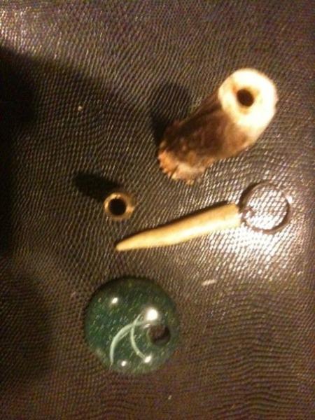

not finished yet but progress update
Ok WOW that respirator is a life savor and I used the Vicks too but as long as I did not take a Deep breath life was just fine! Here is an update pic I made a key chain since I blew out the other part twice drilling it out. I also blew out another piece drilling out. It was not tough to drill out at all just hard to keep center and not blow out the sides.

as far as the blowouts while drilling, remember, the antler is NOT uniform in density or hardness throughout. IE... if you are drilling into the center of the marrow in a curved section of antler and aiming for the center of the far end, the bit will at some point exit the marrow and hit the solid HARD outer shell of the antler. at this point almost any drill bit, no matter what equipment it is in, will deflect toward the outside of the curve. yes, it will cut through the shell too, but it will deflect away from it to some degree. Sometimes this deflection away from the straight line between the two end points may cause it to blow out on the far end. That being said if you are blowing through the center of the inside curve, then your antler is either too bent, too small , or you didn't offset your centerpoints far enough to to the outside.
