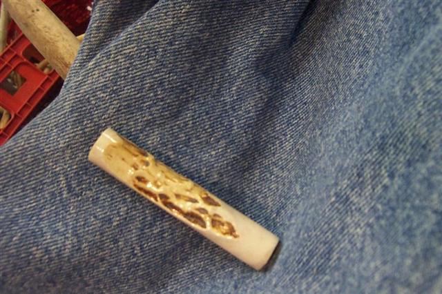

Whitetail 3&1/4" long for"long wood" style slimline
Natural color
