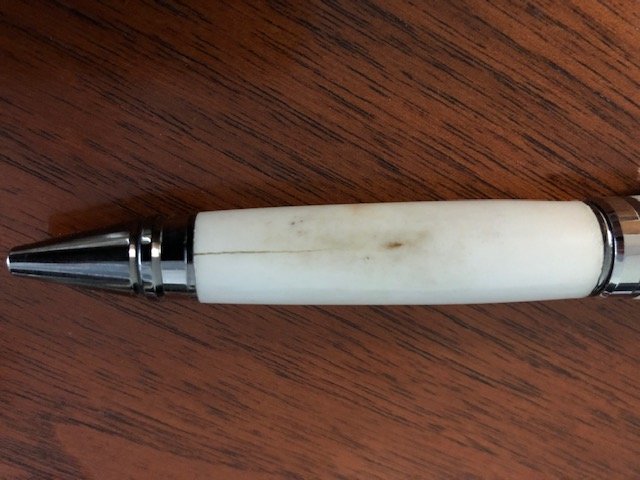

I'm attaching a picture of one of the pens that cracked, this is the most common type crack, but I have seen them split from end to end with the antler totally separated from the tube, no glue holding it in place.

Has to be the extreme shifts in temps. We tell people not to do exactly what you are doing. Now would it help if the blank is not glued in with CA, who knows it may. Don't forget metal too expands and contracts as well. Not as much as woods and other materials but all happening and gluing to a solid surface to is asking for a problem and that is why I always use epoxy for gluing pen tubes. If the other shows that you do there is not as much temp shift could be the clue. Remember too if you press those fittings in there is pressure applied to those thin ends and maybe any small internal crack is just exposed now. I believe the temp shift is your problem You can get away with woods and acrylics and even metals but as we all know some woods are temp sensitive too like snake wood.
That is a stress crack. How to relieve the stress in future pens? Allow movement. I don't think you can control your environment totally and you do have a wide range of environments.
We know that the speed (quickness or slowness) at which newly shaped metals (by heat) are cooled or quenched dictates the crystalline structure and hardness it takes on. It might be that at certain temps, the quickness at which the pens are heated or cooled in changing environments could itself be the cause.
My theory is that there is stress on the blank due to pressing in fittings and is exacerbated with the temperature fluctuations. Best solution for crack prone materials is usually to ream out tube to get a slip fit and glue fittings in. An interesting test would be to bring some drilled, glued and turned blanks to your next show at this location but not assembled into a pen. Perhaps some drilled only blanks as well. What happens to these if anything will go a long was to better identify the problem.
