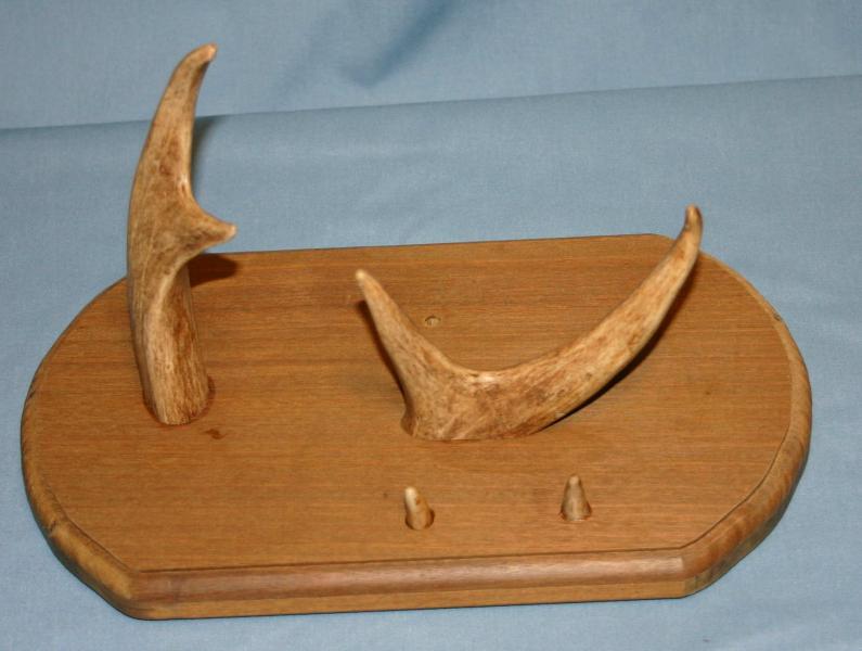

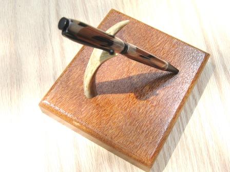

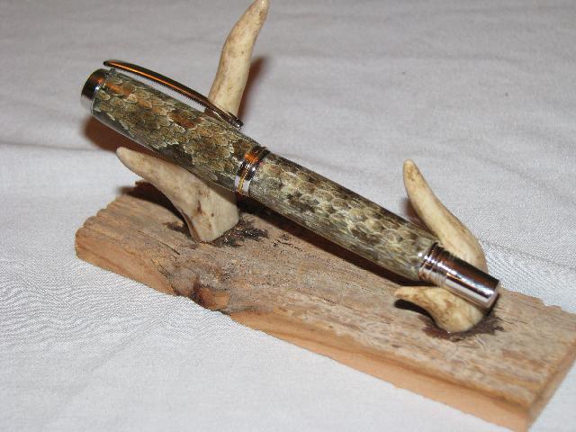

THarvey here is the only one that I have a picture of. I simply screwed it down from the bottom of the base. Hope this helps.

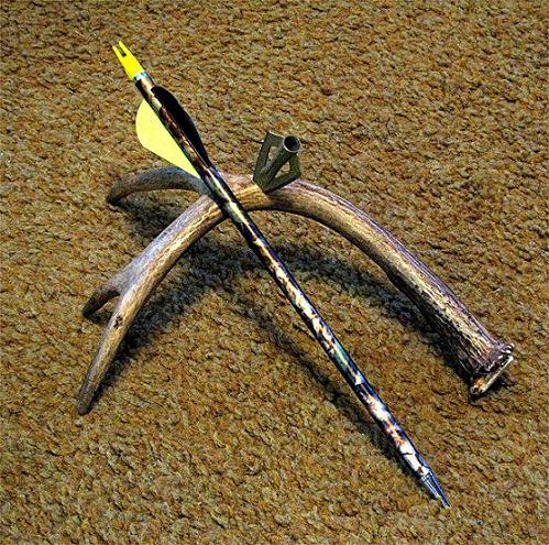

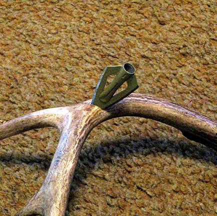

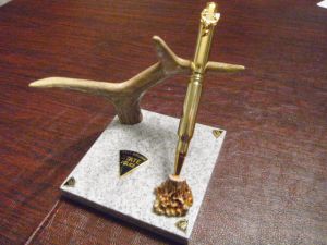

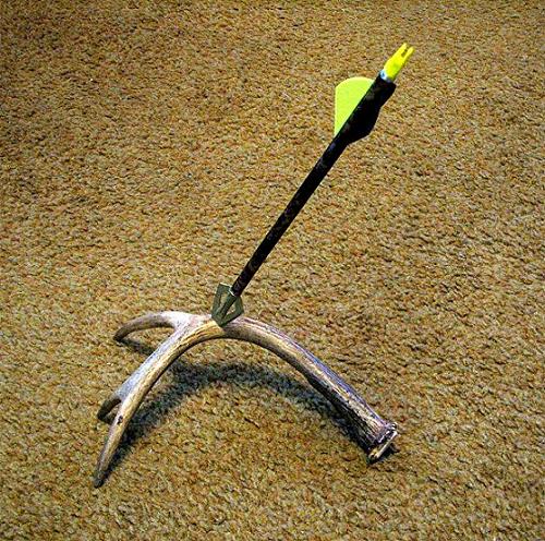

Here's mine. No wood though.

Okay, Steve, I give up.
How did you mount the arrow in the antler, without showing a cut kerf?
The rack I am currently working on is for a 30-06 cartridge pen, desk set. However, my pastor is a bow hunter. Your setup looks like a good idea for him.

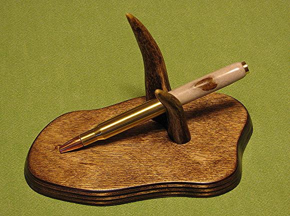

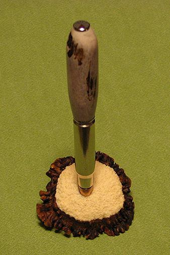

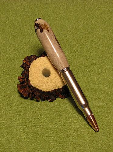

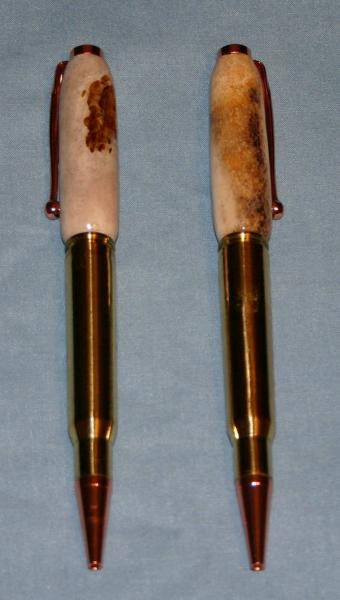

Two More Possibilities

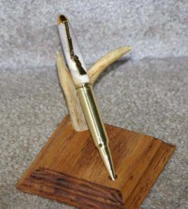

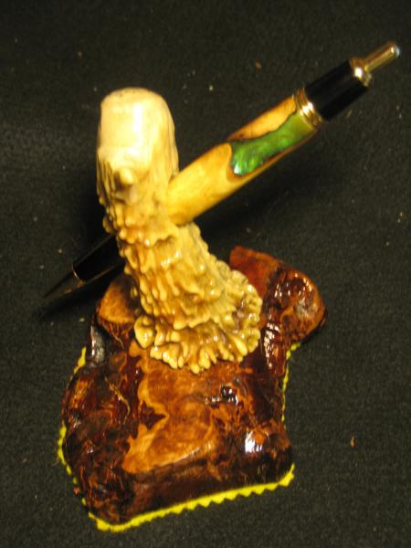

Tim,
I've been dabbling with a couple more stands. The first stand uses a forked piece cut from the end of a 4 point antler. It is attached to the simple wooden base with epoxy and a screw from the bottom. The rim at the case head fits nicely in the thin web edge between the forks to hold it from sliding. The second stand is made from the burr of a whitetail antler, turned over, drilled & molded to match the bullet nib.
The pens are both cartridge pens without clips to go with the desk stands. The first is a brass 30-06. The second is a nickel 308 that I turned with a fat end to preserve some of the live edge.

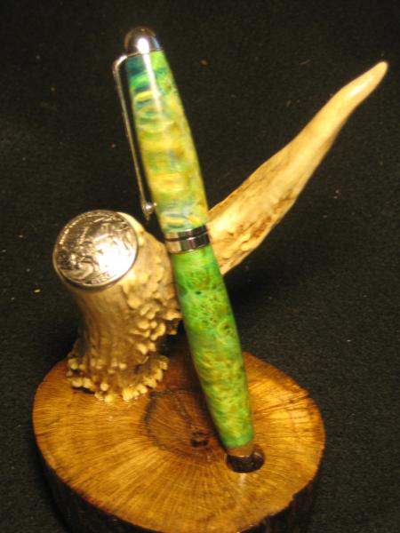

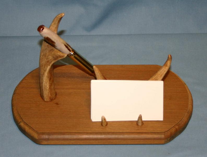

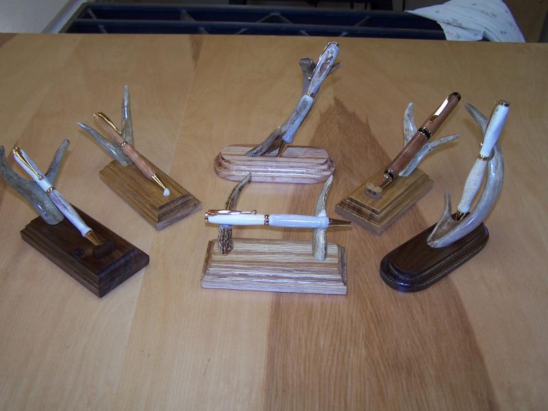

Here's a couple of mine. They sell really well at shows. The antler is a piece I can't use for a pen and the wood is usually shop scrap so there is very little cost in the stand. They sell for $15-20 each.
