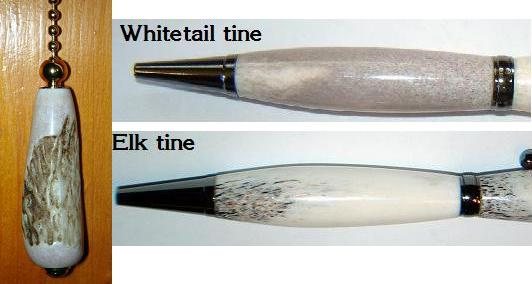

Something to keep in mind, tines make a nice pen because, like above, less marrow, but if you can get a small rack with lots of stubble at the base, its nice to drill off center and get some natural antler texture in your pen surface. Another idea is to make chain pulls out of the base if its to large for pens. Ive included of a pic of that. Its one the first I made so the shape is lacking but you get the idea. I also included whitetail tine pen and elk tine pen. Elk marrow has a nice look to it as it shows through the outter antler. Remember you never know what your going to get with antler until you turn it down. Colors can be grey, red, purple, white, yellow, etc.
